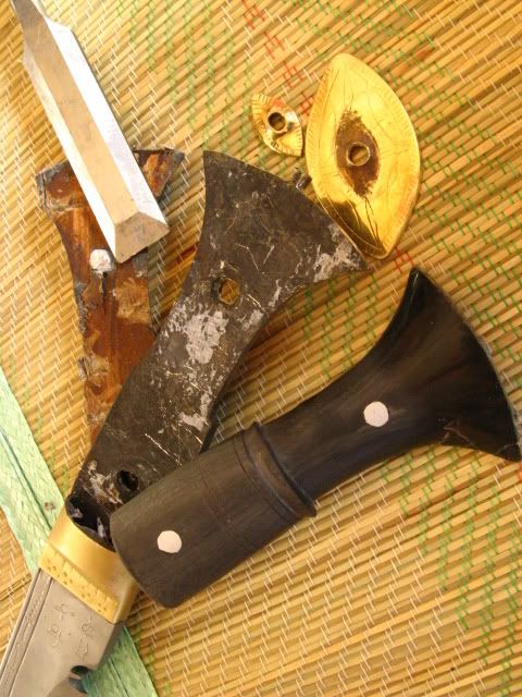

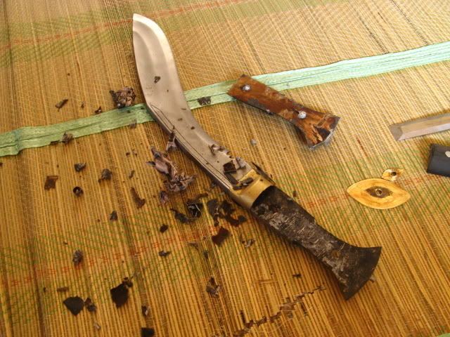

First thing to do is grind off a bit of the peened tang that holds on the buttcap and keeper. Then you put the handle in a plastic bag and soak it in boiling water for a couple minutes. It doesn't take long for the laha to soften.
These pictures show the buttcap and keeper.

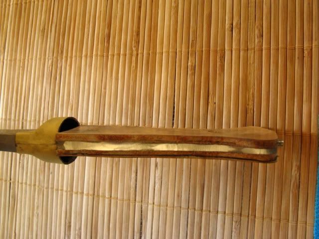

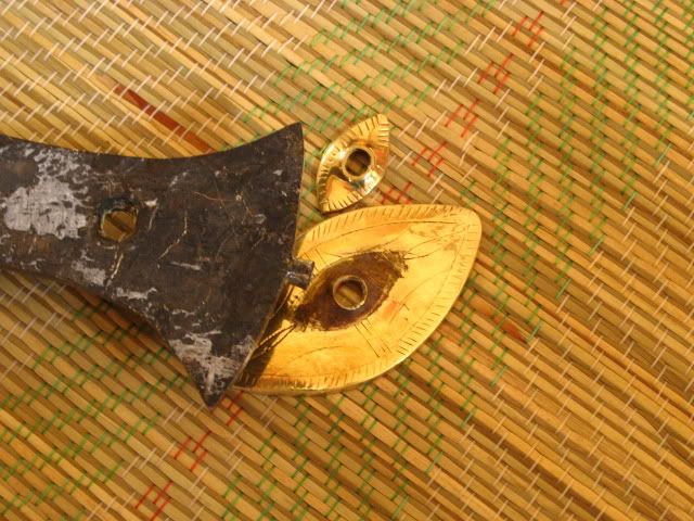

I pry the buttcap off a little bit and then remove the scales. Using a chisel you can easily seperate them. I actually cut the pins with the chisel. They are very soft and you can cut them with a couple blows.

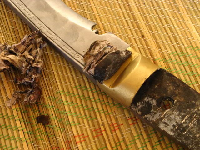

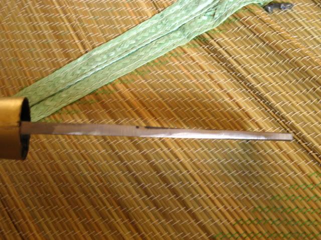

Ever wonder what is inside the bolsters? My experience has been laha and newspaper. You can see that the tang is full thickness all the way through the bolster.

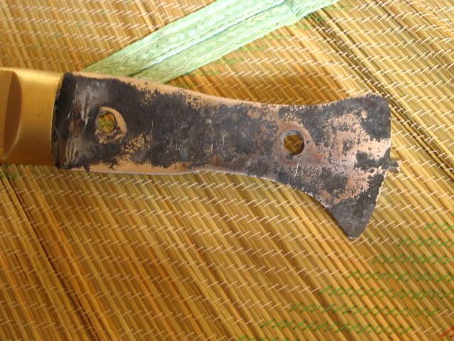

Soaking the handle free tang some more lets you scrape off the remaining laha and you end up with this.

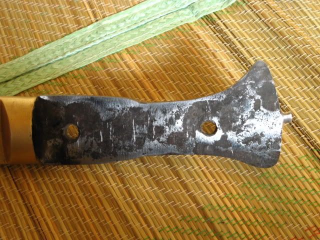

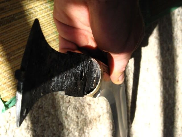

A little preliminary work on the tang with the grinder and belt sander helps reshape the tang to my liking. You can see the surface of the tang is very uneven and tapered as well. This makes fitting the new scales a bit more challenging. I"ll rehape most of the handle profile with files.

The tang extends all the way and is peened onto the buttcap.
The bolsters on the 2 I have taken apart were filled with newspaper and laha (Nepali epoxy). I have yet to dismantle a hidden tang so I"m not sure what is lurking underneath.

The pins on the HI khuks are very soft. Perhaps aluminum. One good whack with a chisel and you can cut them in half.

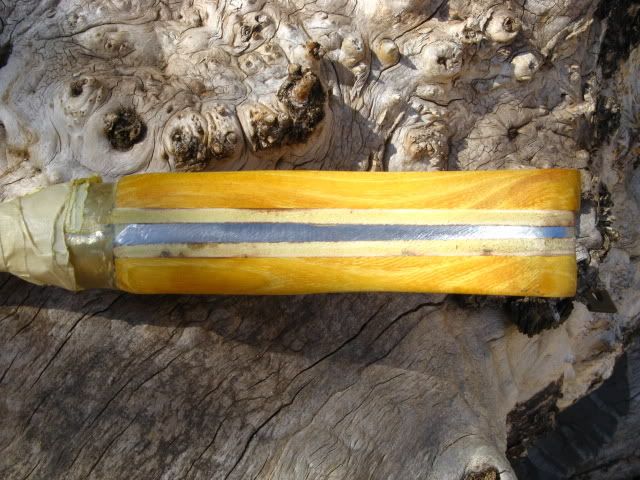

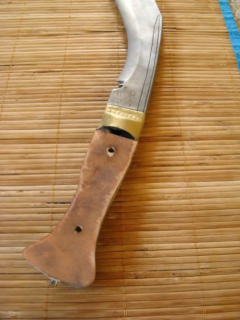

Stage 2 is my attempt to eliminate the need to fully flatten the tang. My lack of powerful grinding tools and general impatience led me to the following solution. I needed something thick that could be compressed so the tang irregularities and taper would be a non issue.
So I epoxied some 9-10 ounce leather onto the tang. Then I got my osage scales ready and put in some hollow 1/4" stainless pins.
Since the weather was wet and cold today all I did was take down the scales a bit with a drawknife. Tomorrow I may do more between sheath work.
I have seen leather used as a spacer before, but never quite this thick. I think once I get the handle shaped I may drown the exposed leather with as much superglue as it will hold. The leather may add some shock absorption also. There is a fine line between not enough movement and too much. I guess time will tell how it will hold up.

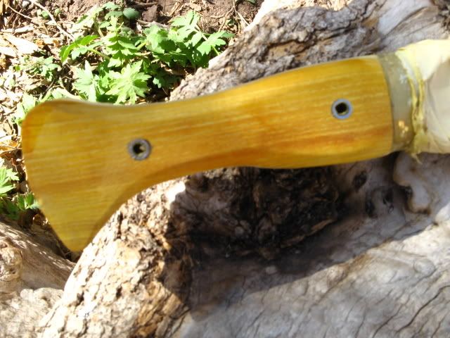

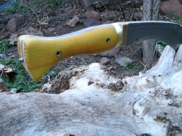

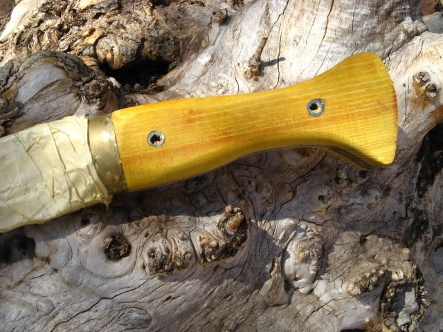

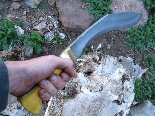

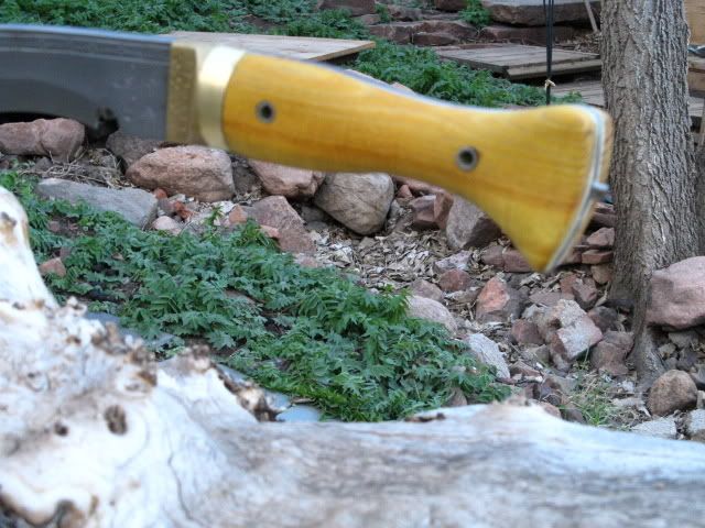

These pictures show the scales filed down to match up with the tang. I got most of the contours done but it is too dark for pictures. I think I still need to take it down a bit for the best grip.
I"ll saturate the leather with superglue after it is all sanded and then I'll give it a danish oil soak before finishing it with Briwax.
I lied. Just enough light for a couple more pictures.
I need to thin it out around the bolsters a bit and also on the top part of the swell towards the back. I'm going to epoxy and peen on the keeper for fun.
