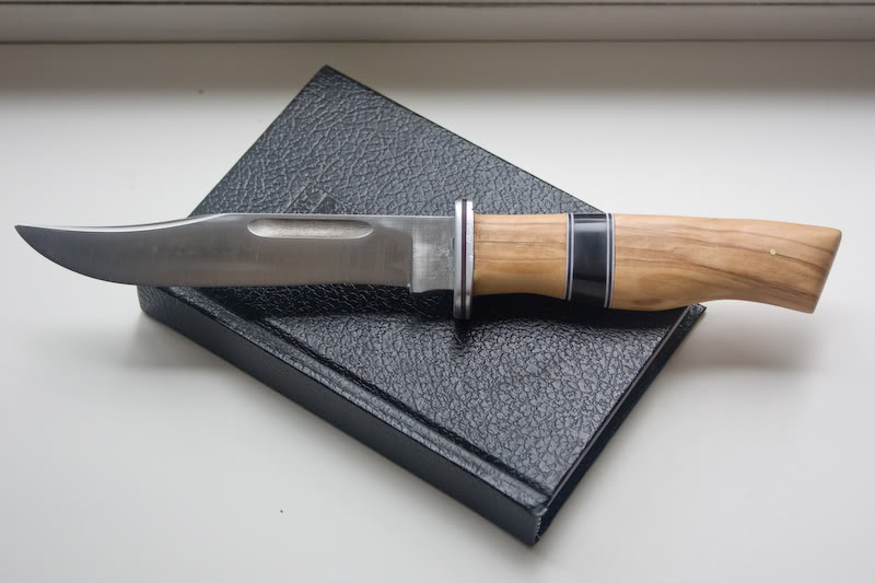

Don't sweat it - seriously you have a blessing here.
a nice ironwood or walnut or burl handle will make you love it much more : )
and you get a great 'rona project
post pics! you'll thank your wife

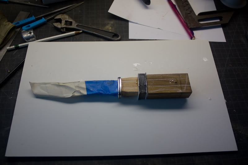

These are pretty easy to rehandle actually, as long as you are handy, and it really helps to have a drill press, and a belt sander is good too. The short version:
You want 3 pieces of handle material: 1 for the guard, 1 for the middle and one for the pommel.
It looks good if the guard and pommel match and the middle contrasts. The middle can be wood, but the pommel and guard should be metal or g10 or maybe micarta. The ends of the middle portion need to be parallel.
You need to drill out and then file the guard so it fits the tang perfectly without gaps on the side where it will be visible. Also it should fit snugly so that it can't be pushed any further forward onto the blade past your desired position.
The middle needs to be drilled through & filed for the tang to fit through, but leaving a little extra size for the JB Weld or epoxy or similar to fill it in.
Assemble the guard and middle on the tang and line up the pommel underneath the tang so you can mark where to drill the whole for the pin that will secure the pommel to the tang (can be a solid pin, or mosaic, or a hollow one for a lanyard whole). Then drill and file the channel in the pommel for the tang to fit into.
Slather the tang with epoxy, put the parts together, once it dries it you can file and sand it to your desired shape.
For the middle portion you can also do stacked leather or g10 spacers instead of one solid piece.
The Brisa website had a tutorial on putting handles on stick tangs.
Or search for Puuko handle tutorials.
You can do this.
I had no prior experience and did these with a drill press, files and sandpaper.
A couple tips. Clean prep makes good glue bond. Epoxy won't stick to vaseline coated blade. Vinegar will remove unhardened epoxy.
Oh yeah, and in my experience, power tools help me make my mistakes much faster. I rough shaped with an 80 grit belt by hand or held over a big file. Other tools used, double cut half round file, drill (drill press is better but a hand drill is good) and sandpaper from 80-600 grit.
Take your time enjoy the process and don't rush for results.
