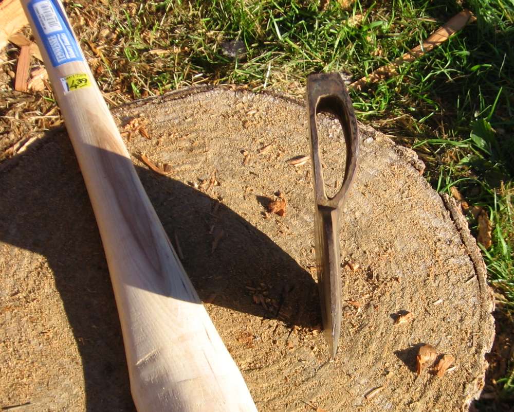

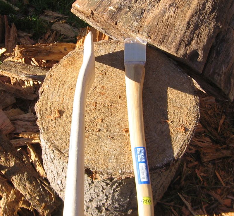

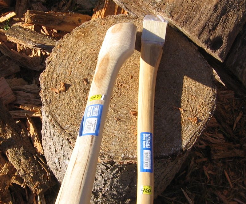

I found a couple really nice handles at a local supplier the other day. I've got some work to do.
Both handles are a little fat but they have perfect grain.
I stopped by that same supplier yesterday and today and picked up two single bits and one double bit handle. Neat store with the widest selection of handles I've seen. Bought a scraper there, too, to remove the lacquer. Can't wait to see your finished products!
