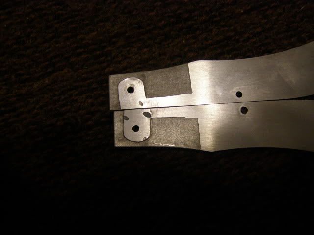

One of the reasons I've put off messing with slip joints for so long is I could not relieve the liners and still have them decent looking. I tried dremel, stones, drill press, and scrapers and they all looked like I hacked at it with a chain saw. Tonight I laid out my liner then place electrical tape over the inside of the liner. I took a scrap liner and made a pattern of the area that I did NOT want to remove. I laid that over the electrical tape and cut it out with a knife. I then removed the pattern and the electrical tape that had been cut leaving the steel exposed. My next step was to use my homemade etcher and etch the area I wanted relieved. It seemed to work well. My steel pattern was a little rough, I didn't know how it would work so I didn't spend any time cleaning it up with files and sandpaper to smooth the edges and what not. Here's pictures of what I did. I"ll clean up the jagged parts of the pattern and smooth it out some, but I think this is going to work. I don't think the etched area looks horrible compared to my hacking at it with a dremel. Let me know what you think. Ryan
Please ignore the divots. I spot welded my bolsters on and I've got to figure why it's leaving divots.

Are you spot welding before or after you relieve the liners?

Your getting divots because your getting it too hot when your spot welding it. try it on some scrap with a bit less time on the trigger youll see what im talking about.

Chuck I tried grinding the blade down thinner than the spring, but I couldn't get it within the tolerances I liked. Do you have any tips? Mine alays end up way thin on one end then thick on the other. I did my spot welding before I relieved the liners. There were actually 4 divots but the etching wiped some of them out. I think I'm going to try to smooth the points on the spot welder I think I can stop the divot problem.
Thanks Rusty ill try less trigger pull. I have a 220 volt welder do you think I would be better off with the 110? Possibly stop it from getting too hot? Thanks.

You seem to have good control with the etching method Ryan. You may be onto something very useful. I have had my liners take off like a helicoptor in my milling machine.

Like Bruce, I think you are on to something with the etch. As far as Bill Burke, he has relieved the liners on the mill and I have seen him make and use bushings. I also use the milling machine to relieve my liners.
