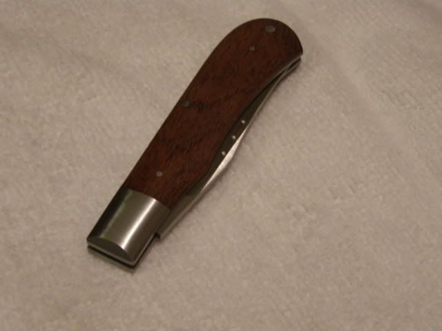

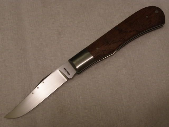

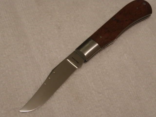

Not the best picture, my bride, secretary, photographer ect will take some better pictures tomorrow that I will post in the gallery. This is the knife I have been working on. The blade is hollow ground cpm154 hand rubbed finish and a ground swedge, half stop, the nail pull is fine silver and has three small studs on each side. The bolsters are 416 stainless and the handle is the customer's request of mesquite. I've made 5 slip joints I guess so far and the first 4 where 3 years ago and I've tried to buy them back to no avail. I did another set of relieved liners with the etcher on this knife and seemed to work great.
