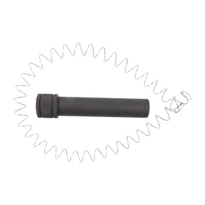

I would add a magazine extension before I added a side saddle. http://www.brownells.com/magazines/...mington-870-magazine-extension-prod43001.aspx

If you have 7+1 capacity the extender pictured won't work.

Get the magazine extension, it'll work, 870's (express and wing masters have a 4+1 capacity).
Only issue you'll have is the express has the indents in the end of the magazine tube that holds the plastic end cap inside the magazine tube for the spring retention.
To put the magazine extension on and have it work you have to get rid of the indents, I drilled mine and then used a dremel to smooth the holes out.
Could have saved a whole lot of typing if you read the post first. He already has 7+ cap.
