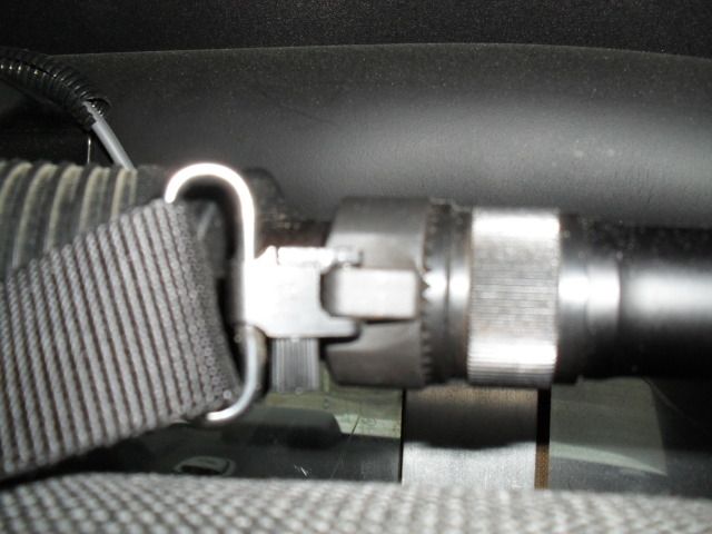

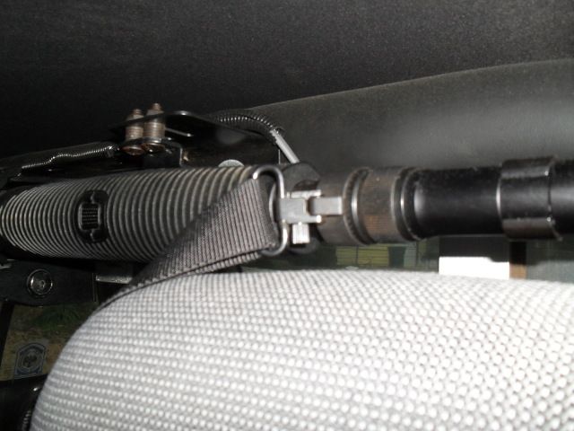

This is my Remington 870 12-gauge Super Magnum Express:
I cut the barrel down from 26" to 18.5". I installed a Knoxx/Blackhawk (non-recoil reduction) stock, installed a Hogue "Handall" rubber grip onto the pistol grip, a Hogue rubber forend, a +2 magazine extension with clamp, a receiver shell carrier, a receiver sling mount (for one-point sling), a "tactical" follower, and a flame green HiViz front sight. I also smoothed the trigger and "tuned" the magazine spring.
