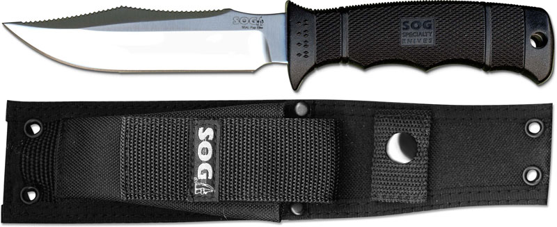

SOG SEAL Pup Elite with Kydex Sheath, SG-E37K
Specs
The SOG SEAL Pup Elite Knife features a 4.85" plain edge clip point bowie blade made of AUS8 stainless steel, .185" thick, with a Rockwell hardness of 57-58. The blade of this SOG knife has a satin finish and a blade spine rasp for notching, filing, and thumb placement. The finger grooved ergonomic black Zytel handle has a lanyard hole. A Kydex sheath is included. The SOG SEAL Pup Elite Knife with satin finished plain edge blade has an overall length of 9.5", and weighs 5.3 ounces.
If you shop around, you can usually find it for between $50 and $60.
