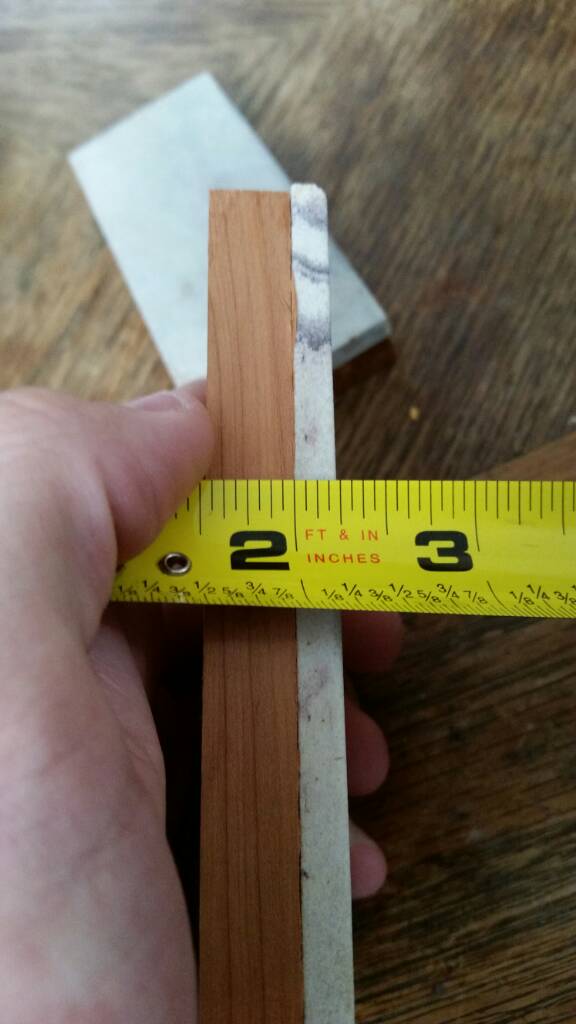

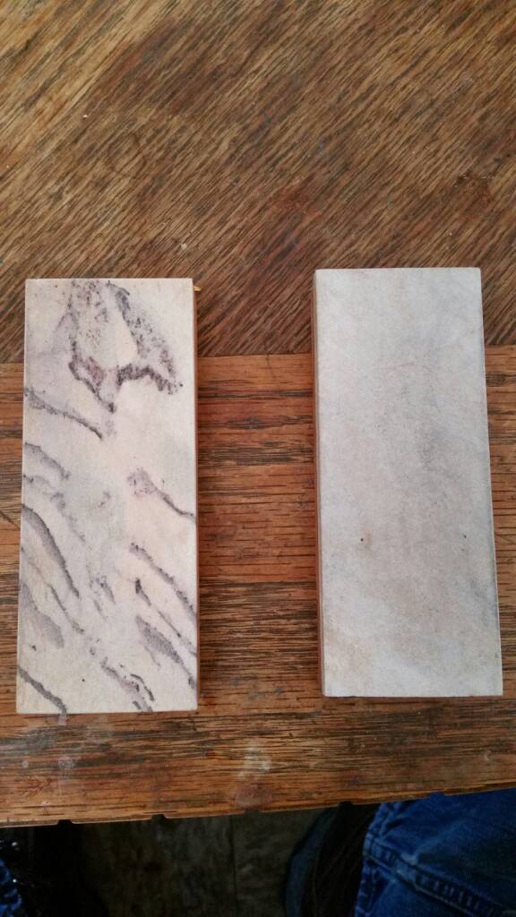

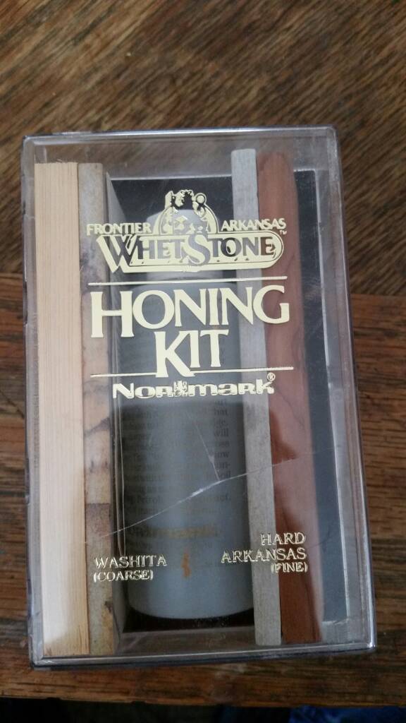

I bought these stones at a yard sale today and I won't ed to remove the wood backing. Dose anyone have a good reason not to or is it safe to do so.
It is safe to remove them and by doing so it gives you another side of the stone to use. Go for it. DM
The rear of the stones may be unfinished. It will have glue on/in the stone. This will have to be ground off with sandpaper.
Therefore-the back side will not be usable until you refinish it.
This could be true. But we don't know until they are removed. Toward the glue-- yes. Hopefully they didn't use a good glue and the resin will come off with ease. Still, both sides of the stone could be finished. DM
Wood was added for support and/or height and/or cost savings.
Sand the wood, soak for a week, should pop off no problem, if it won't pop off, the wood will be easier to work. .250 stone can break pretty easily.
I guess I have to ask the reason why would you want to separate the stone from the base?
The base gives you height to keep your knuckles from hitting the surface as the stone wears down.
There are many ways one can give the stone this clearance. Which doesn't require it to be glued. Just rest it on a notched 2X4 will give a sharpener plenty of room without hitting his hand. Two side of a stone doubles the usage. Good job Willis. DM
