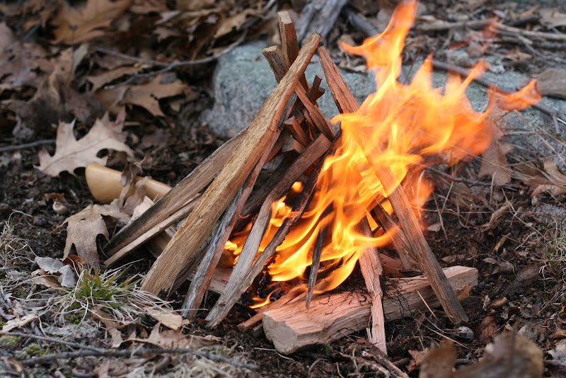

I buried the head of the hatchet up to the eye in the soil.
I then built a fire on top of it. The fire was large enough to cover the head. The wood used was oak. I continued the burn for 15 minutes.

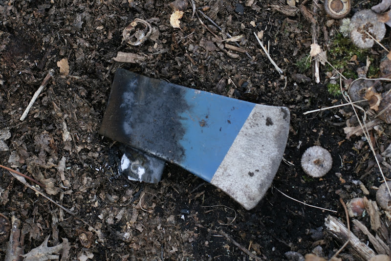

I then pulled the head out of the fire. The handle had burnt off, but surprisingly, the head appeared untouched by the fire in the areas that were buried.
I used a piece of split wood that I had left from making the fire, and with the help of a baton, I pushed the handle through the eye from the bottom. As you can see, the area on top of the eye was not too charred, ut the bottom part had been burnt much more severely. To punch out the part of the handle in the eye, just prop one end of the head on the ground, and the other end on a log. That should create enough free space under the eye for you to push it out.
With very little effort, the head of the axe was free from the handle.
I was shocked by how little the head was effected by the fire. Most of it retained its original paint, and even the rust appeared to be untouched. While the head got hot, it never even came close to being hot enough for the temper to be effected. Even the poll of the axe, which was directly exposed to the flame, never got red hot. Despite my scepticism, this appears to be a very effective way to remove an axe handle while in the woods.

Burying the head did protect the blade and edge. I am thinking the heat would still soften and weaken the eye which is partially hardened.
Actually, the eye is almost never hardened - it's almost always left soft and tough to better dampen the impact of the bit. Even with very, very soft steel eyes deformation of the eye is quite unlikely without abusive usage of the poll. Remember that prior to steel being widely available, axes were made of iron (much softer and malleable than steel) with high-carbon steel bits being welded into place.
I didn't wet the soil around it, but it was kind of damp.
As far as the poll, killa_concept is right. It is usually not hardened to begin with, so this shouldn't effect it in any way. It is supposed to be soft.
With respect to the bit, from what I understand, you have to heat the head quite a bit to change the temper. The way they used to judge how hard it was goint to be was by the change in colors from red to blue when it was heated. Here it just got warm, but nowhere even close to being that hot. As you can see, even the paint was not touched. In fact, part of the label is still on.
It is very hard to judge small changes is temper with a file. I can tell the difference between hard and soft, but that's about it. I did the same thing with a Northern Tool hatchet as well, because I know where the temper line is on it. After putting it in venegar, the line was in the same place. I don't know if there was a change in the overall temper. It was hard to notice just by filing.
I highly doubt that a 15 minute stick fire would heat the head enough to ruin the temper in the bit, especially buried in a great heat sink like damp earth. As noted already, any temperature that high would have burnt the paint off long before, and clearly that didn't happen. Bury that head in hot coals for a while however, and things might be different.
