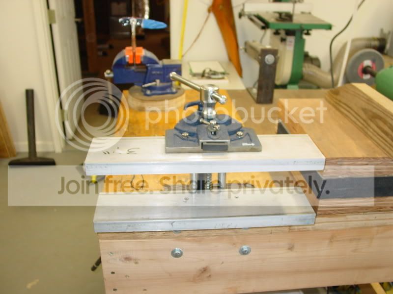

Here's my plate quench set up. I saw this set up on BF. I just mounted a wood workers vice with a quick release vertically. I attached two thick aluminum plates.
-John

Barker, that is an awesome setup - I gotta make me one of those - mostly I deal in 440C, which (I am assured) is air quenchable. Thanks for the photo. Is that 1" thick aluminum you have used?
And I have just bought a LOT of ATS34 (about 6pieces x 72 inches) from Admiral, cause they were out of stock on 440C. So that kind of plate quench will get a lot of work. My shop is kind of portable, but I can see setting that up on a WorkMate (folding tool bench).
Thanks again.
Yes, I got those plates off *bay for about $30 to $40. Drilled and tapped them. I use a fair amount of ATS-34 and always plate quench. The best thing is it minimizes warping. You should try some CPM 154. You will like it. On the vise make sure it is a quick release.
-John

Quick release is important to close the vise quickly. The plates need to come together very quickly while there is still an orange glow. You don't want to be there turning the screw to close the vise all day while the blades are cooling. And you want it open pretty wide to get them in there with the tongs. Time is of the essence. Not so big a deal to open the vise, but to close it.

I oil quenched ATS34 and 154CM for many years, battling that cursed foil to get the blade out quickly. I switched to quench plates, blade in foil, and it has given me the best as-quenched hardnesses ever for these steels. Scrounge yourself up some aluminum plates of decent size. While i have the same setup as Barker, many people just put one plate on the floor, place the blade pouch on it, lay the other plate on top and step on it.
