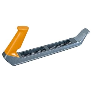

A coping saw will help you get your profile roughed in. Instead of files, try a wood rasp. A 10" half round should remove material in a hurry. For flattening a Stanley SurForm Rasp works well.

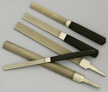

There are some relatively new files out there that I've had great luck with. They are called "carving files" or "cabinetmaker's floats". One company is making them now - Iwasaki. I'll post a couple of links below.
They are sort of like a combination of a file and a rasp. They remove material fairly aggressively, but leave a smooth surface like a file. They also come in three different levels of coarseness - medium, fine, and extremely fine. The also come in flat and half-round and in a couple of different lengths/widths.
I do all my scales by hand (e.g., coping saw, carving files, sand paper) and these have really made life simpler. I use the medium for hogging off material during the rough-out phase. Then I switch to fine for the shaping, and to extremely fine for the final pre-sanding touchups. They aren't cheap, but they are highly recommended.

Rasps are great, as are Magicut files.
