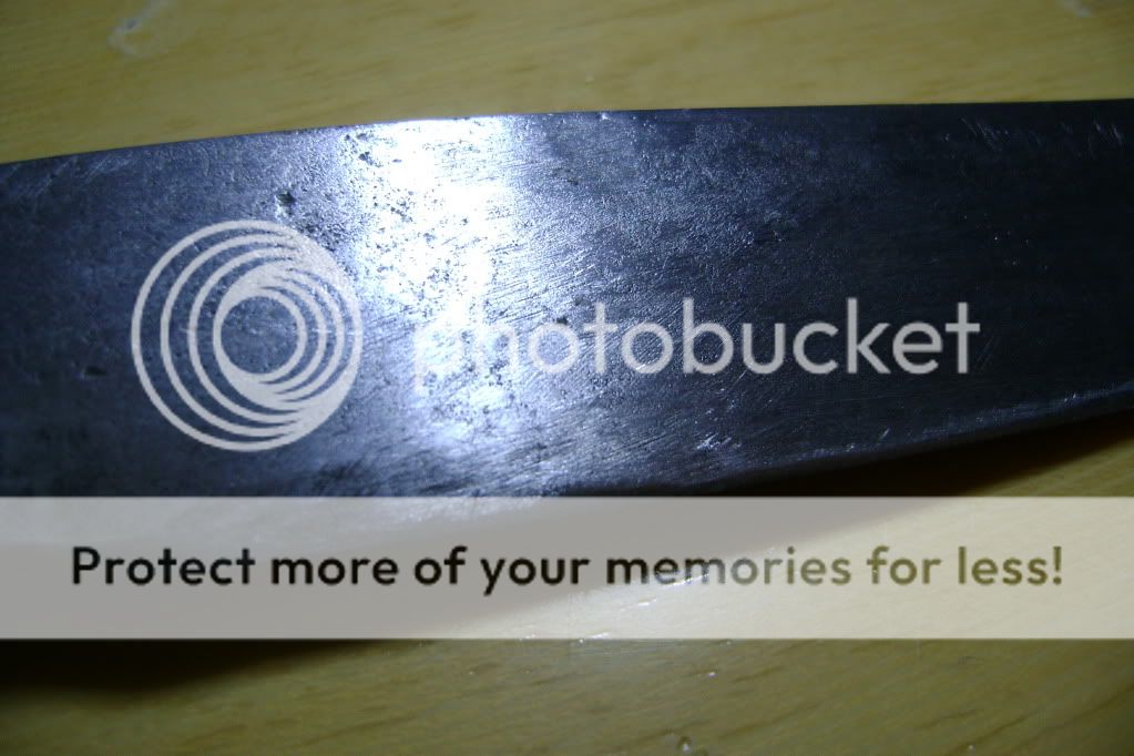

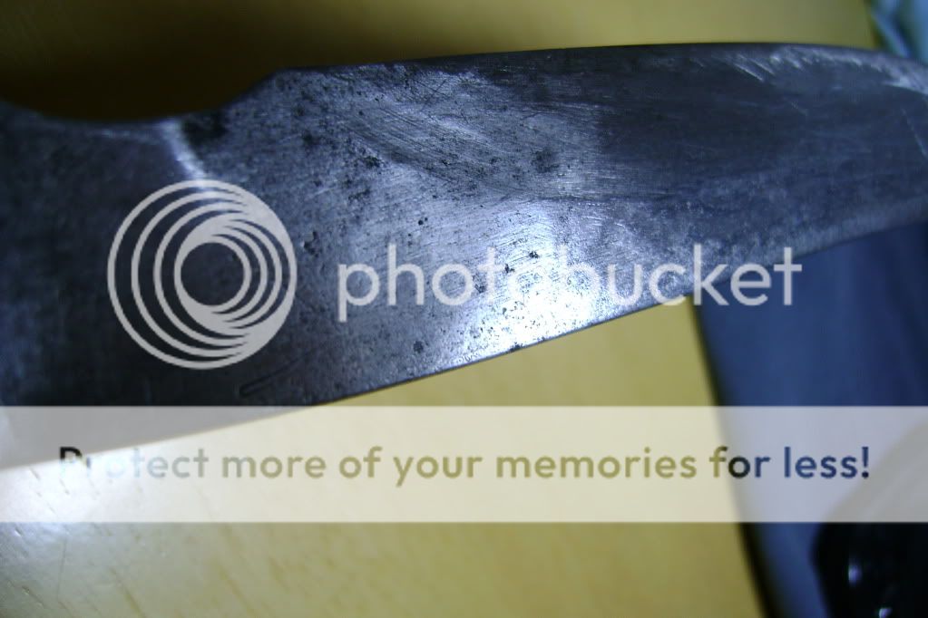

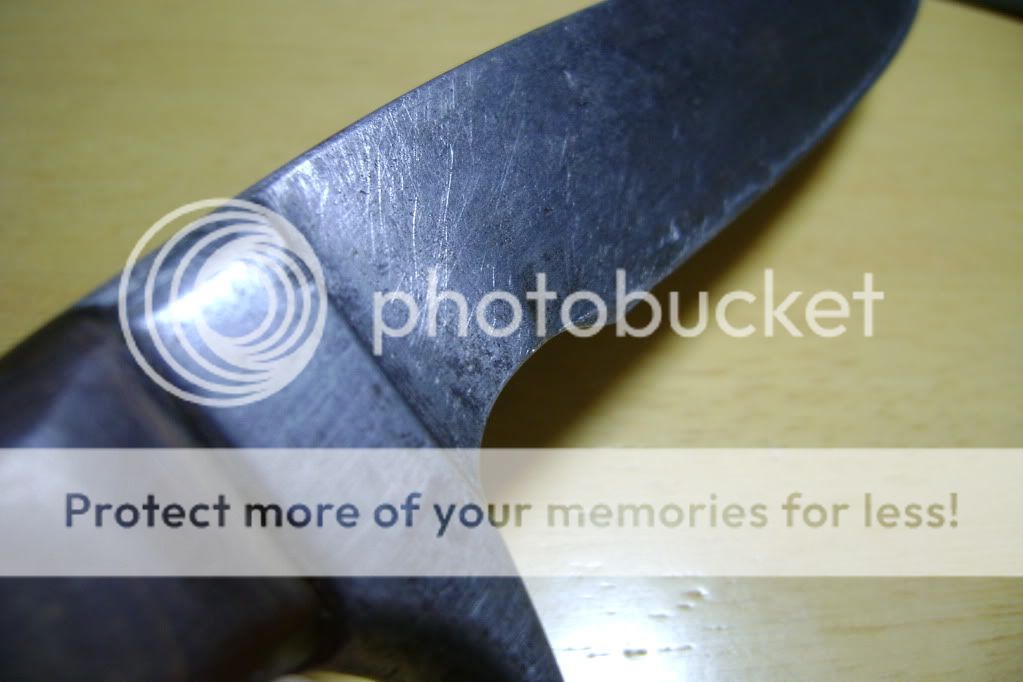

Hi,
Sorry i didn't express myself properly last time.
The fact is, i wasn't with the knife at the time, and did not really remember how was the rust.
So today i got it and took some photos, and realised i was very wrong in my description, haha
and here they are:
I did what you suggested, put the knife in a roll of towel paper infused with wd-40, it will rest the night that way, tomorrow i'm gonna see what comes out of it.
Thank you very much for your help,
Guilherme
The pits won't go away. The only way to remove them is to sand/polish the blade down past the depth of the pits.
Oh, of course if they are deep i cannot remove them. There is no way to remove a hole, right?
But i would be happy if only i could remove the superficial stains and at least clean up the pits, so they wont look dark...
That blade actually looks pretty clean to me. I don't see any red/brown stains in the pics, so I don't think there's much reason to worry. The 'dark' coloration is likely the 'black oxide' that forms on the surface of steel when exposed to oxygen in the air. It's otherwise known as 'patina', and it's a good thing. It provides a small bit of protection against the 'red oxide' (rust) that might otherwise form and corrode the steel.
If you do want to remove the dark spots though, some polishing paste made for hardened steel (Flitz/Simichrome) will likely get it done. Brasso is formulated for softer metals (as the name implies), so it may or may not clean it up. But it won't hurt to try. Keep in mind, even after polishing the patina away, over time it will re-form. It's a natural process with steel.
