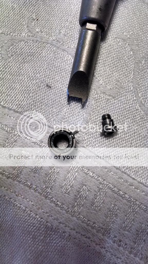

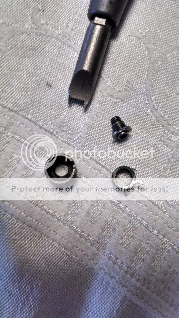

I just acquired another 470 that came to me totally disassembled. A previous owner more determined than myself made a tool to open the pivot assembly by grinding down the edges of a ¼inch spanner bit.
Once the pivot is disassembled its a simple matter to remove the spring and put the knife back together. Opens just as fast without the assist and now it swings closed as easily as any other axis lock model. No issue with hitting the back spacer either.

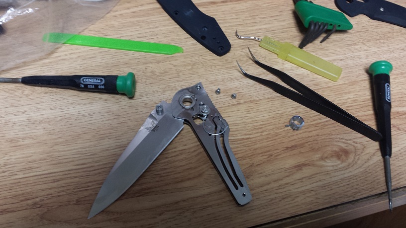

For more followup, decided to try my hand at de-assisting...
It was actually really easy. I used a pair of tweezers (made for grabbing computer screws) to twist off the spring assembly. This one had what looked like Vibra-tite on the pivot, which is like loctite but doesn't dry (it's just sticky to prevent the screw from moving), so it came off easily.
This pic shows what I used for tools (not that they're all necessary)
After that, like spketch said, the spring pops right out of the pivot part, and you can reassemble.

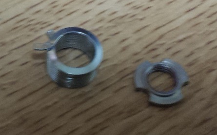

So in the end you're left with these for extra pieces
Why that nut needs to be left out is a mystery to me, considering with the assist spring in there (and nut), there was no play. If anyone can figure this out, I'd appreciate the information. I'm rather confident it wasn't the order or tightness of any of the body screws because I tried them in many different ways.
