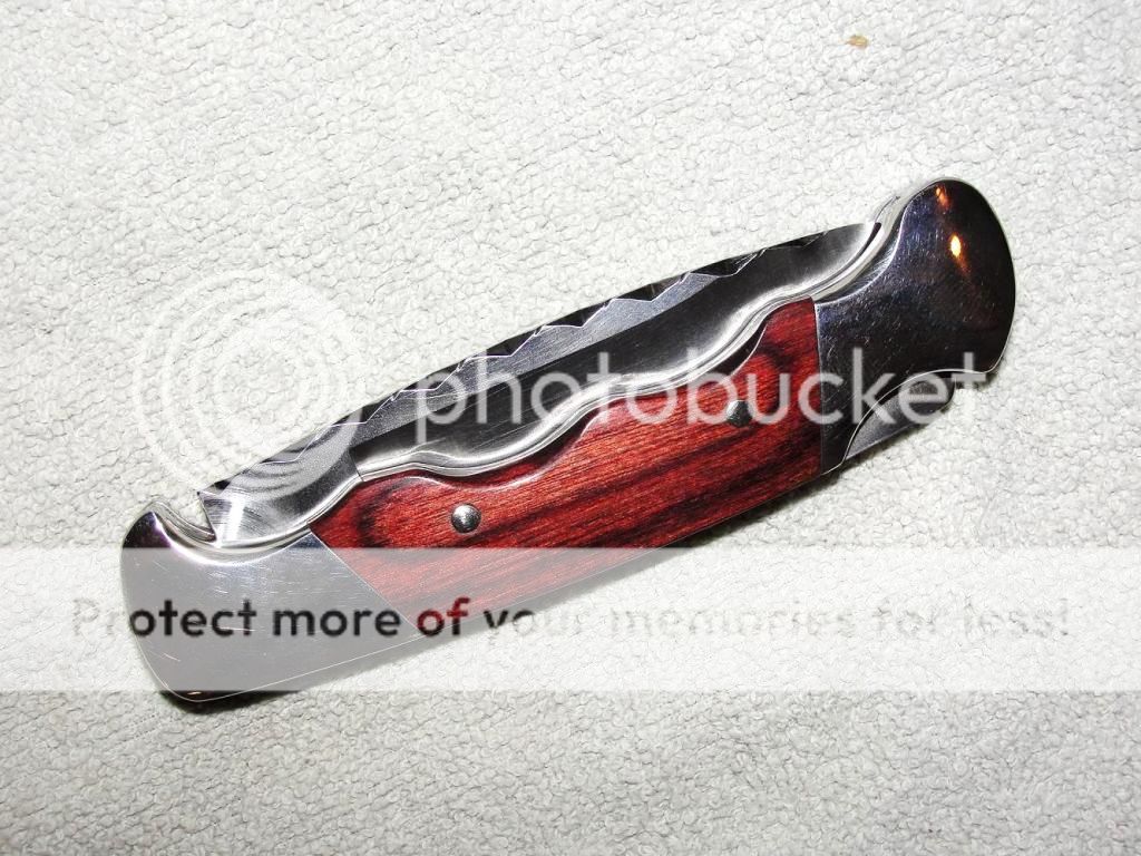

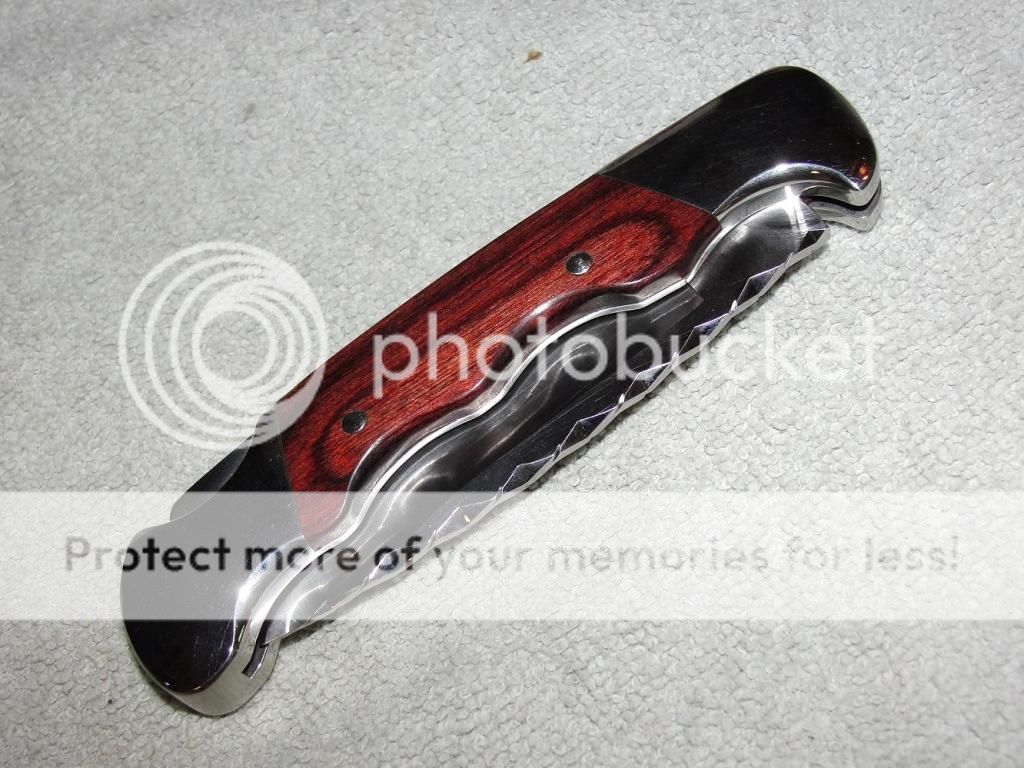

Here's a Buck 500 drop point I added a full set of finger grooves to, and later some vine-work on the spine using 1" stone cutoff discs in the same flex shaft machine, followed by fine rubber abrasive wheels and finally a 1" muslin polishing wheel. This was a lot of metal to remove with a small hand setup,....about two hours as I recall. Had to keep it all cool so grind a bit, and dip in water,...repeat! :)
I own several of this Buck model. The one at top I left stock. The middle one I added just a front an Index finger and pinky finger groove. The bottom knife the full finger-groove set and "file work". The steel was too hard to use a file though,....hence the "stonework" was done freehand with a 7/8" stone cutting disc, followed by tapered fine grit rubber wheels to smooth it all up! :)
If you do a folder, be sure NOT to touch any of the back side of the blade cutting the finger groove. That spot on the blade presses against the spring when the knife is closed, and if you cut even a little away there may not be any tension on the blade when closed may move a little. ( as well as create a "lip" on the spring/bolster area at the back) I went pretty close though....
I carry the full finger groove knife (one of several knives for EDC, and each does a job well) in a simple leather pouch I sewed up. It fits snug, and keeps the hinge end out of the trash and lint in most pockets. (hinge end at lowest part of pouch)
Measure carefully and work S L O W L Y and even a stone cutoff disc will do some nice work....
