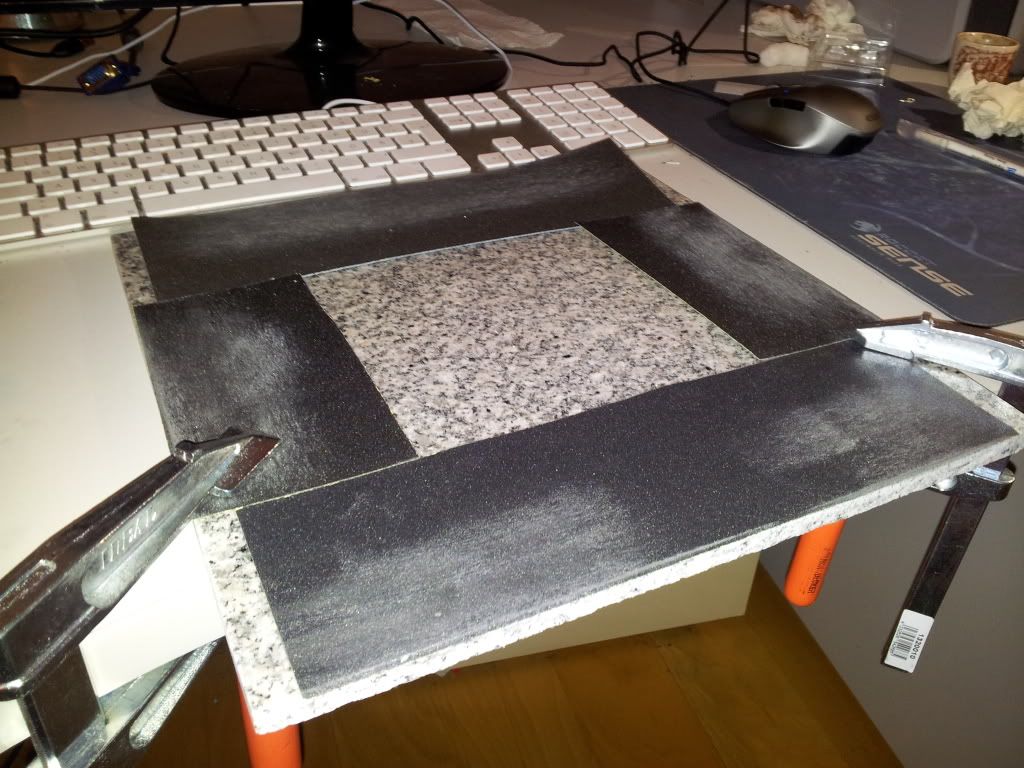

This is my izula so far ... tomorrow i will continue with a better finish.
@BryFry thanks a lot, without your advices i wouldn't even start with this stuff. I bought today a small smooth marble plate and used spray on adhesive that's what it looks like ;)
That is looking great so far Mr. ItchyTrigger! I like that marble plate, that should work well!
One more tip I would give you is to try spraying some WD-40 on the paper. As you sand you will work up a black slurry of oil and sanding stuff, when it gets bad just dab it all off with a paper towel to remove most of the nasty, then spray some more WD on again and repeat. This may sound strange, but it will truely help you acheive the best sanding results!
Also, though it doesn't really matter if you use a back and forth motion on the lower grits, you should make all careful one direction passes on your final grit for a nice even look.

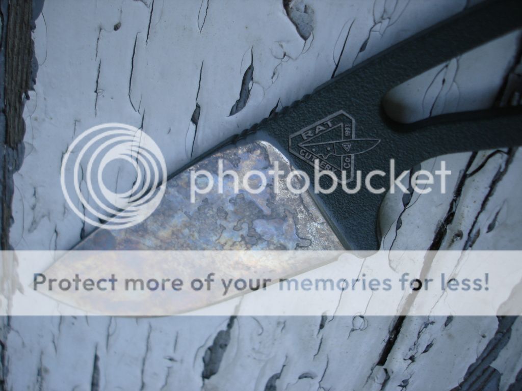

Oh, and since you asked... this is what my blade looks like after using it for about a year or so...
...Not as pretty as before... but I don't mind, it's a great little user!

BryFry, that user patina looks great! It's a dilemma when polishing blades, that if u use the knife it won't stay pretty. I'm inclined towards mango patinas lately and have started to mess with bleach and blueing, but my izula was polished to 1200 after following Bry Fry's Junglas mod. I dunked it on pcb etchant for 5 days after painting and taping the edge, brushing off the marks 2 or 3 times a day before stripping and polishing.
been using it lately, but still try to keep it shiny. Performance was vastly improved with the polishing.
