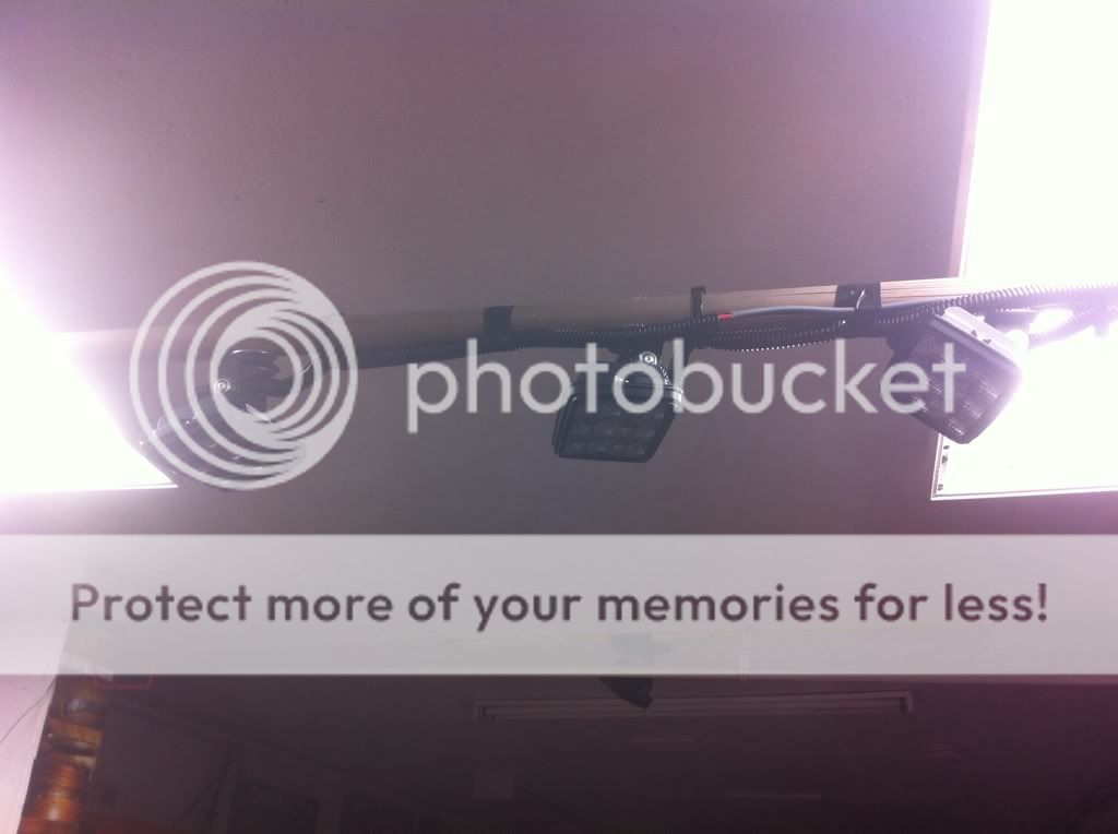

I am in the process of designing a 12 volt LED lighting system in my shop.
I still need a solar panel and a small windmill and inverter but I will have those in the near future I'm sure.
I'm excited to have a knife done using power from the wind and sun.
The lights I am using are Grote 63611 LED flood. They are incredibly bright and draw only 1.4 A @ 14 volts!
Looks like I am going to need at least 8 of these lights, I though 2 or 4 at most but.... time to start saving

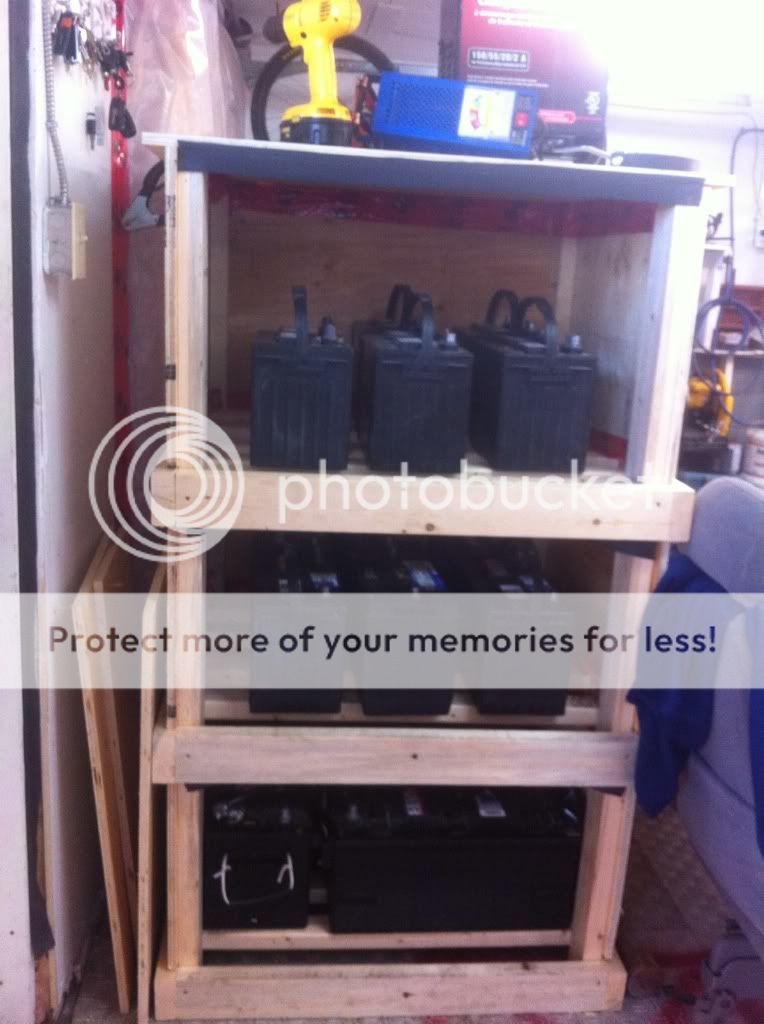

Batteries are slightly used deep cycle giving me about 900 AH, should allow me to work for 2-3 hours on Solar power a day if all my math is correct. I also have a 12v ventilation fan and a 12v powered sink. I suspect I will try using a 12v bilage pump to water our lawn from a rain barrel.

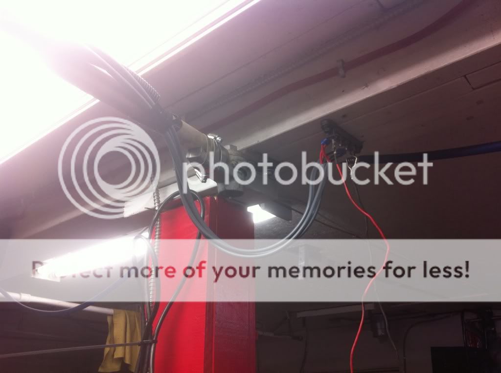

I am nearly set up with Lighting, Batteries and an Inverter for my tools. Here's some pictures.
Sealed and soon to be vented Battery Box for use indoors :
A GMC Safari Van Idler arm acts as a pivot to pivot my LED's over each station. (wiring not complete)
