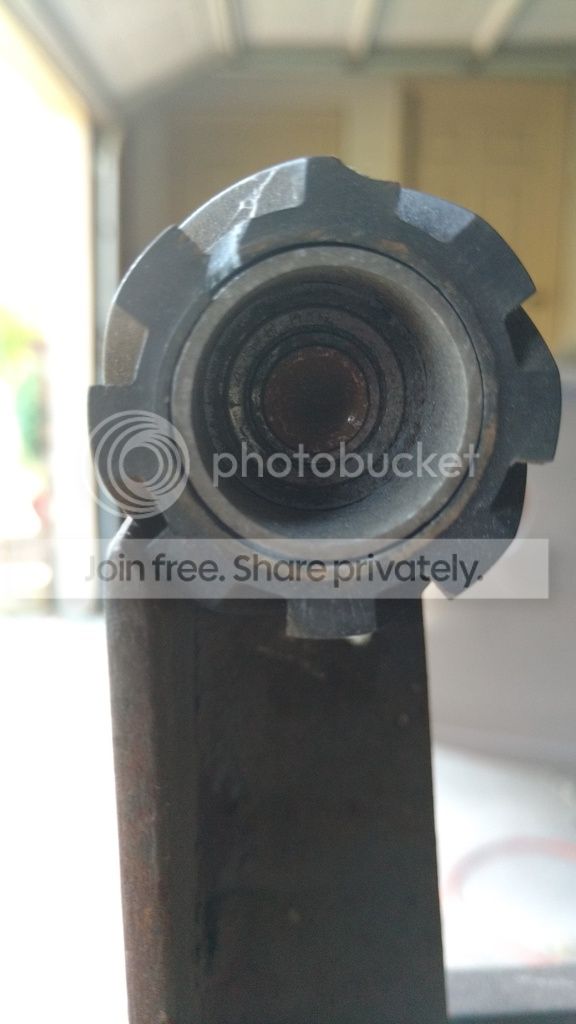

I need to replace the top wheel of my flat platten. The rubber came dry rotted and came off. I need one that is 1.5 inches. Everything that I have found is either 2 or 3 inches. Does anyone know where I might be able to do d one that is 1.5 inches?

First, you need to tell us what type platen and grinder you have. They are not all the same.
Second, why can't you use the standard 2" wheels. They are sold by most every grinder maker and knife parts supplier as well as industrial suppliers.
Last, the 1.5" wheels should be available from an industrial supplier like McMaster-Carr, or can be made by anyone with a metal lathe. If you had a good wood lathe, you could probably turn the aluminum wheels on that. Oregon Blade Maker would probably make you a set - www.oregonblademaker.com
It doesn't have a manufacturer plate on it although the machine was definitely not a garage project. The platten on the other hand probably was. If I go to a 2 inch I would have to cut the flat some but then I am worried my geometry would be off and I would get convex grinds.

That's an odd duck. I would take this as an opportunity to replace that entire platen with an adjustable one. The whole kit, wheels, platen, platen mount, from Oregon blade maker is relatively inexpensive.
It wouldn't hurt
Different wheels mount differently
If he wants direct replacement swap outs, it would actually be helpful.
He posted a pict? Did it help :rolleyes:
1.5" contact wheels are not common and have to be ordered for that size.
Just because he posted a useless photo to ID the grinder doesn't mean that a grinder ID is useless.
I was / am thinking if it's that old, it may be a square wheel = and those have a completely different mounting system than the typical put a bolt through a bearing mount.
