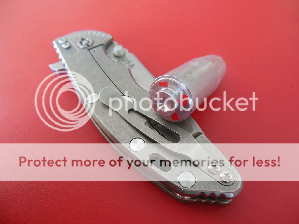

I made two sets of PB washer to replaced the teflon on my two 3 1/2" XM-18s. Here, shown one set along with the homemade, Strider/Hinderer pivot disassemble tools:
This is a lapping tool, similar to the one I made to lap final thickness to .0147" on the four washers:
Along with good grade lubricant, PB washers installed XM-18's pivot action are truly transformed and without blade deflection:
