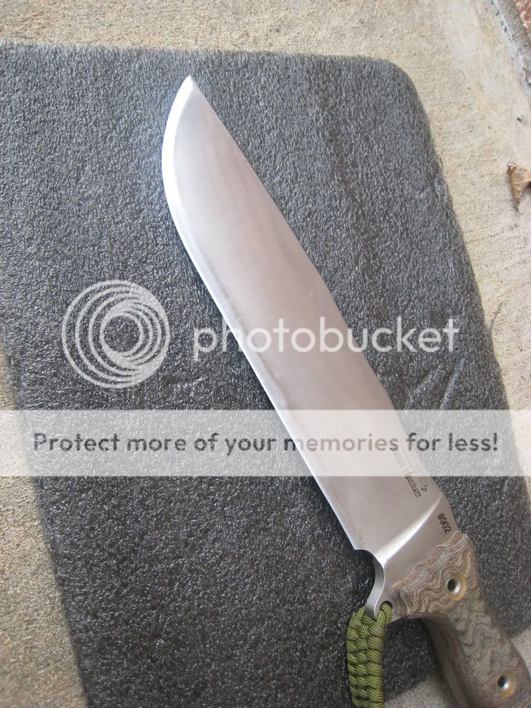

I'm looking to semi convex the edge on my FFBM so it'll bite more when I chop with it, and wondering how long it usually takes. I'm doing it by hand, not the best idea since there's so much infi, but wondering if it's possible.
It's certainly possible, and very doable. I usually start at 100 grit, because the lower grits leave deep scratches that don't like to come out. I glue a piece of leather to something that won't move like a table ( i use Elmers for easy clean-up). Then use elmers to glue sheets of sandpaper to the leather, and remove them when you are done with them. I use 1/3 sheet at a time, and change it rather frequently.
A typical hand-sharpening for me looks like this:
100 grit
220
400
1000
2000
2500
Mother's Mag Polish on it's own strop
a clean strop
Finished. Allow about 2 hours for your first attempt.

I did this one by hand a while back
tomthebaker, thanks for the advice, and thanks for the pic of your LE, I'd like to see if I can get tiger hide scales put on mine one day (if it's even possible).
I spent some time on my FFBM today after taking it in the woods and giving some fallen trees hell for about an hour.
My supply of sand paper is getting low, and the variety in grits is lacking, or I just can't find them.
I did manage to somewhat achieve a semi convex edge, took a while, but I need to work on it more once I get some more "lower" grit sand paper. Current edge is nicely polished though, and pretty sharp, but a sharp knife can always get sharper :D

I hand convexed the edge on my FBMLE.
I would I started at 60 grit, but would not recommend going that low. It becomes less effective I think.
I think 100-200 grit cuts just as fast to me. Just replace it more frequently so It cuts faster. Some one above said, scratches from 60 grit are a pisser to try to get out later. Also, if you don't want scratches higher up on the knife, you can tape it off, or leave the coating on if it is coated.
The real key is to keep it light. You have to keep the weight of the knife up a bit (I used a mousepad which has more give. Leather backing would probably be a better choice for that big knife. The mouse pad works great for lighter knives, but for the heavy suckers, you will get a sore shoulder holding all the weight for hours and hours at a time to keep the material from wrapping back up the edge).
I don't have a real good photo of the edge. I did not blend the convex as high up as some.
My hats off to all you maniacs who managed to do this by hand. Belt grinder plus 15 min=sharp BM.
I got a very sore shoulder, from keeping the full weight of the knife off the mousepad.
Took me a couple evenings in front of the TV.
