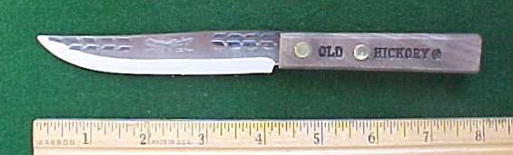

I got an abused Old Hickory knife from an antique dealer the other day... I said, "How much?" and he looks at it and says, "Uhh... Why don't you just take it."

Now I want to convert it to a reasonably period (1700's) but very functional patch-knife for black powder shooting.
Clearly, I have never done this before. How about this:
1. Scribe the new profile of blade.
2. hacksaw off what I can taking care not to bend the blade.
3. Grind to the line+a hair all the way around.
4. File to the line.
5. Fit a more appropriate handle.
6. Sharpen.
I know I mustn't let the blade get too hot.
Otherwise, I'd be happy to hear anything you have to say.

Tony, that is ruff! The price was right:thumbup:! I think you're on the right path. My question is, can you salvage the handle that's on it now, or, do you want a different material? Please lets us know how it turns out, we love this kind of stuff. (I know I do!)
The handle is dry and helpfully says, "vegetable" on the side. I have some cherry, white oak, red oak, and walnut in the barn. I bet I could get antler if I chatted with a taxidermist. I'm leaning toward cherry. I also haven't decided if I'm going to drill/fill the handle for a tang or rivet the blade back. I think I have a little brass rod suitable for rivets.
I see what you see, Tony. Great idea! Personally, I would go for a roach belly or some other type of patch knife, like you were saying. I would rehandle it, too. I like your approach and don't see any problems with it. If you have a dremel, it might make cutting quicker than a hacksaw, but keep that blade as cool as you can. If you have a extra course diamond stone, like a DMT Duo Sharp, or similar, it might come in handy. Regardless, your thinking is sound and you should come out with quite a nice little patch knife that you will carry with pride.

Note that knife edge where it meets the handle. There ain't no way.
Here's a fetching roach belly.
Some folks have used edge grinders for this work. It is very fast, but controlling temp's are a problem. Other guys I know have filled a 5 gal bucket with water, and ground it in the water, which keeps it cool. You gotta be careful how far into the water you go, or you could electrocute yourself...
May not be an "Old Hickory", but it is made by the same company and fairly old. I'd venture it's the same knife, rebranded.
With a blade that thin, I would do everything with hand tools. You'll kill the temper the second that thing touches a grinder. It shouldn't take too long to shape that little guy with a hacksaw, files and sandpaper.

Anyway, I drove the pins out of the handle and the blade came out. I Dykem'ed the blade and scribed an edge profile on it. I put the steel in the vise and found my hacksaw will not cut the steel - it skates right off! The saw itself is a good saw and the blade is a good brand too.
Well, I wanted good steel... When the gods wish to punish us, they grant our wishes!
So, what's the alternative? I was hoping that I wouldn't have to anneal it - I've never made a knife before and I'm trying to get off easy, lol.
Use an abrasive disc in your Dremel tool, hold it steady, and stay 1/8-3/16 off the line. You don't have to slot the whole edge, make it a dashed line with about 1/4 between slots.

Anyway, I decided to get back on this. I was unable to reshape the blade with files so used the grinder. I didn't let it get hot. I made a new handle from cherry. I spent an hour or so this evening drilling holes for the rivets and sanding.
