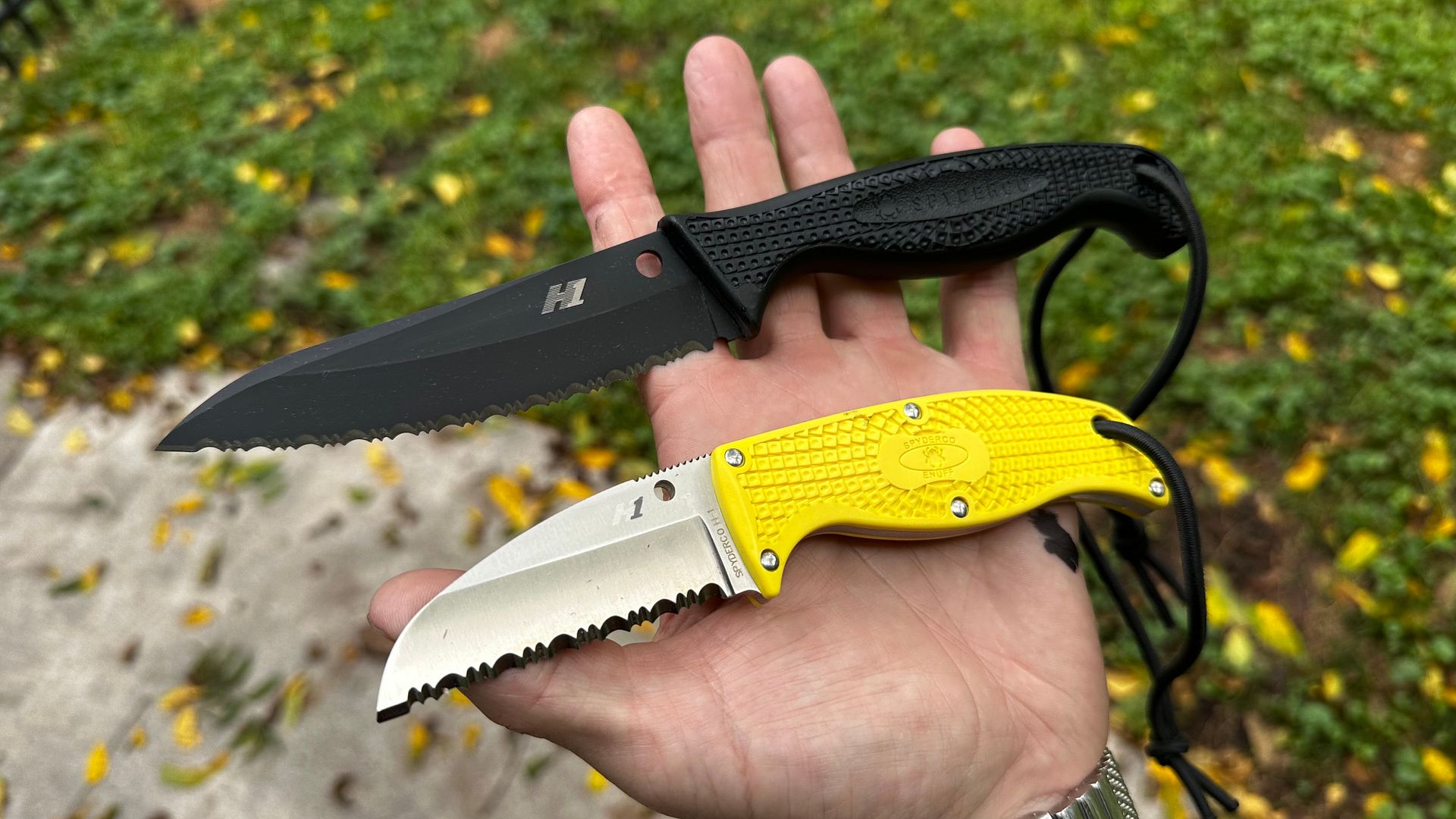

A rescue knife must be able to withstand harsh environmental exposures, you must be able to perform a rescue in a land, sea, and air situation --- for this reason it must be fixed, having a mechanical failure in a folding knife during the most pivotal moments is a death sentence, I also think it should have serrations to cut ropes, as well as belt straps and cords, but not entirely along the length of the blade, some straight edge real estate must be allowed. So If I were to design a survival blade:
a modified sheepsfoot blade in AEBL/20CV/H1/LC200N steel, partial serrated. Fixed with grippy G10 to handle water, and good kydex/carabiner sheath system
The Aqua Salt is a serious hunk of steel. The Enuff is more a rescue knife though.
You could do a lot worse
I believe you 😊
The fixed wharncliffe spyderco looks like it means serious rescue business. And the last one, the wrench-turned-knife will make short work of any windshield I imagine, in the absence of a more specialised such tool
