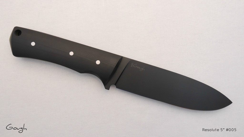

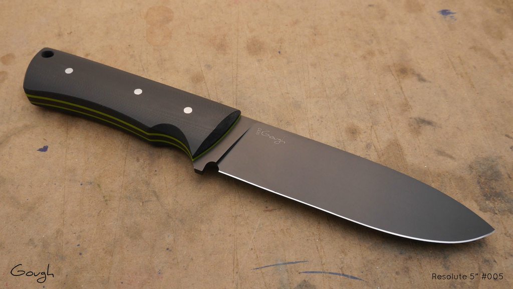

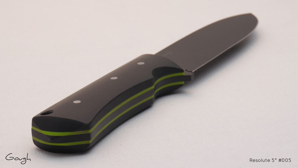

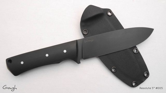

This one has been a long time coming! This knife is the culmination of all the testing and learning I've been doing over the last 4+ months...
Specs:
  • Blade material: A2 tool steel @ 62.5HRC
  • Overall length: 9-5/8" (244mm)
  • Blade length: 5" (127mm)
  • Blade thickness at spine: 5/32" (4mm)
  • Blade coating: Cerakote
  • Weight: 7.7oz (220g)

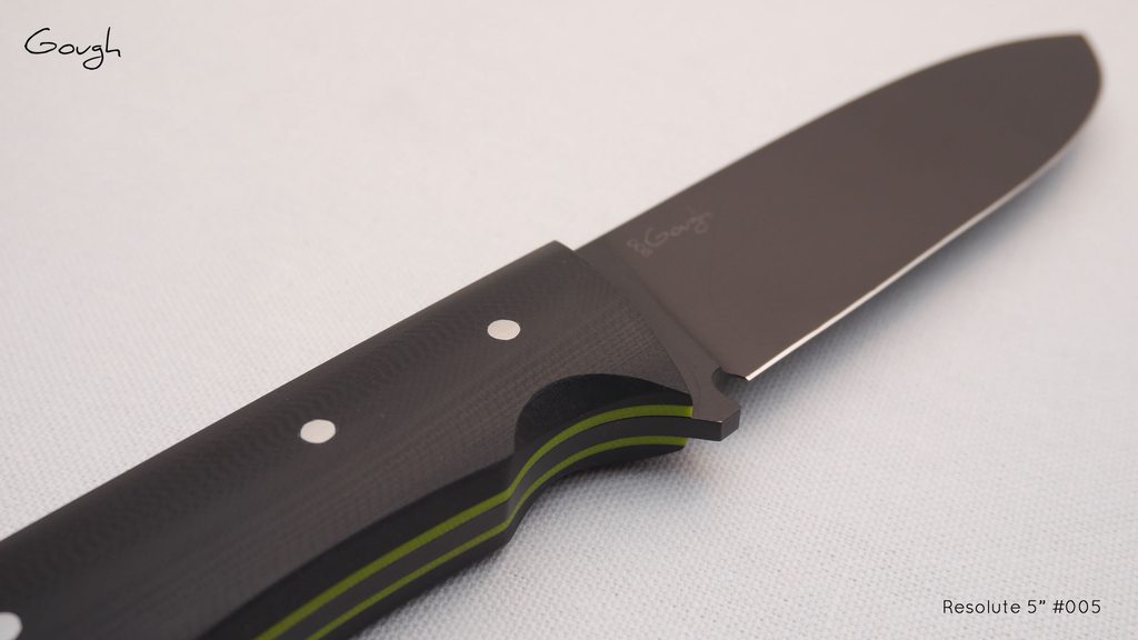

  • Handle material: G10 - black w/ toxic green liners
Things I'm happy with:
  • The blade coating (Cerakote), took a bit of testing and practice but I'm very happy with how it came out!

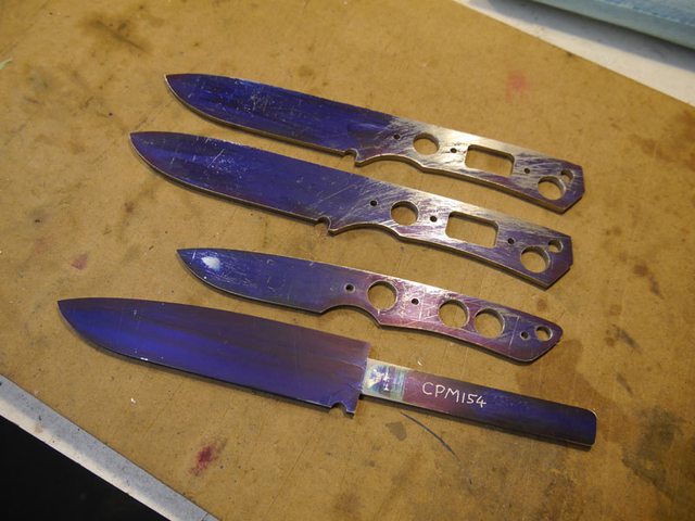

  • I'm very happy with the heat-treatment too. The steel is very hard (62.5HRC) but also still very tough! I think there's still even more left in this steel though, I'm going to continue experimenting!
Things I'd do differently next time:

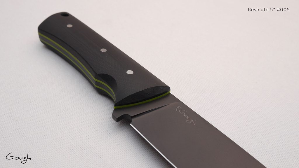

  • The pin holes in the tang were drilled 0.003" oversize to allow the pins to be test-fitted easily. Unfortunately this also caused a bit of slop that made it impossible to get the handle slabs perfectly aligned during the final glue-up. Next time I would drill the holes right on size to prevent this.

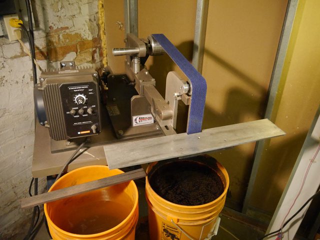

  • I accidentally burned a section of the G10 near the butt when shaping the handle. Disc grinders heat up the material much more than a belt grinder! I've gotten spoiled with my belt grinder...
  • Using anti-scale compound has been giving me problems with decarb. Next time I will be heat-treating in foil to avoid this.
Let me know if you guys have any feedback, constructive criticism or suggestions!

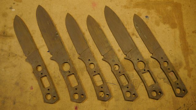

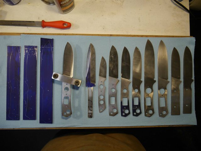

A few random WIP photos:
Hey Aaron,
Love your knives! Very clean! Your videos are also very helpful!! Thank you!
Thanks mate! Glad you've found the videos helpful! Plenty more of them to come as I've found that I very much enjoy making them!
Great looking blade. I would think that a nice blue or red liner would look outstanding (just IMHO). Really like it.
Just beautiful. Love the way the liners set off the whole knife.
Thanks! The liners were inspired by a friend of mine.. I helped him make a Resolute of his own (in exchange for him bringing my KMG grinder across the border), and he wanted black scales and orange liners. After I saw his I had to have one with bright liners too!
Thanks! I actually have one coming up in the next few weeks with red liners, I'll be curious to see how it turns out!
Simple yet elegant! This is a work of a genius! Another beauty. Well done.
Thanks mate! I may still gently sandblast the handle scales on this one, the G10 ended up a little too slippery for my liking, apart from that I'm very happy with this knife!

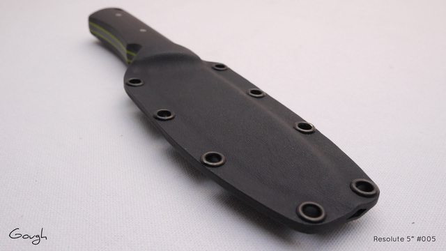

I made the basic sheath the other day:
I'm waiting on some heavy nylon webbing now so I can make a belt loop for it. Tried a number of tek-lock style clips and haven't much liked any of them...
