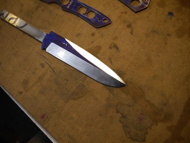

Thanks very much! It took me quite a while before I was happy with my technique for the plunge lines. I think I did 13+ test blades before I got it ironed out...

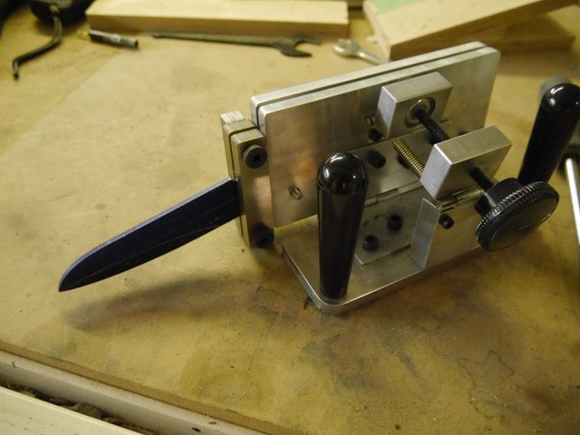

I actually use a jig to do my grinding. Took me about 3 days to make, but it really only required a drill press and some patience, biggest issue for someone trying to replicate it would be the bearing block. I'm keeping that in the back of my head to see if I can come up with a simpler way of doing it. You can see it here: http://imgur.com/a/ffxVM
The technique for the plunge lines is nothing too revolutionary but I believe it's different from what a lot of makers do.
First thing is I use a file guide clamped to the blade to make sure the plunge lines are equal left to right. Then I make sure my platen is dead square in both directions to my work table.
Basically I run the belt exactly at the edge of the platen, using an old file to test when the alignment is right, then I knock the grit off the corners of the belt using the same file. I start with a 36 grit blaze belt, move up to an 80 grit blaze belt, then 120 grit blaze, then 220 grit a/o, then A20 trizact. Every belt is setup the same way, right at the edge of the platen.
Each pass I do actually starts in the middle of the blade, then I work back and touch the plunge, then head back toward the tip.
This seems to work well, I get plunge lines that are identical left to right. Each plunge line is mostly square (which helps it to look crisp) but has a gentle radius right at the corner to make sure that's not a stress riser.
Here is a photo of a blade with the file guide attached, and clamped in the jig:

The jig does actually need to be free to move on the table, as the jig has to rotate relative to the platen when you're grinding the tip in order to keep the bevel looking right...

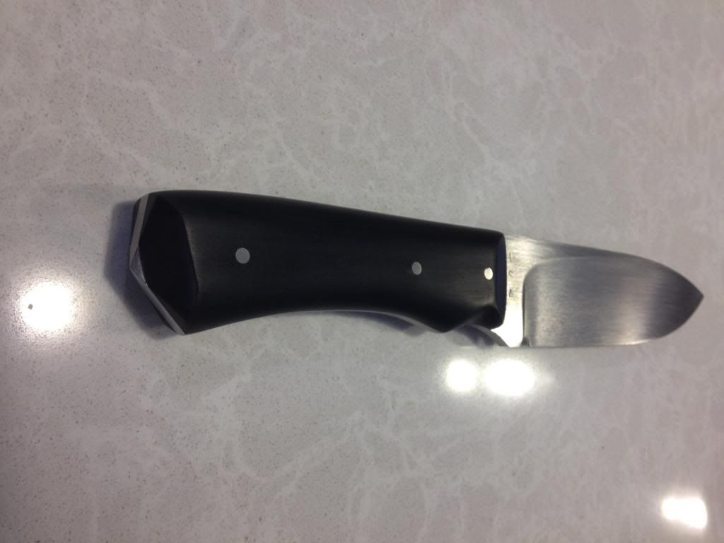

Dude .. just seeing this thread. I really like that knife! The blacked out look and overall lines of the blade design is what's drawing my eye to it.
Critic .. I would have used black pins. The silver pins are causing a distracting pause (to me). The kawasaki green liners, I'm not a fan. That must have been a personal preference. Something more subtle would be more appealing (again, to me) .. like dark gray or dark maroon ..but definitely something more subdued.

The toxic green is something I really like personally, and also makes the knife a little harder to lose. I agree that it won't be for everyone. I'm doing one for a customer now that has black scales with ruby red liners, should look much more subdued I think!
I didn't think I would like the silver handle pins, but as soon as I finished polishing the handle I really liked them! The reason being that otherwise there would only be one line of silver on the knife at the edge of the blade itself. I have to work out how to Cerakote the pins or otherwise knock the shine off them though as my military customers definitely won't want shiny pins...

very nice looking Bush crafter knife you have there. It hard to tell from the pictures, but if you get any hot spots from the edges of the handle. you might try rounding them a little with some 400-600 grit paper.

Thanks mate! The handle corners are all rounded a bit to make them comfortable while still retaining their angular look, seems to work well!
