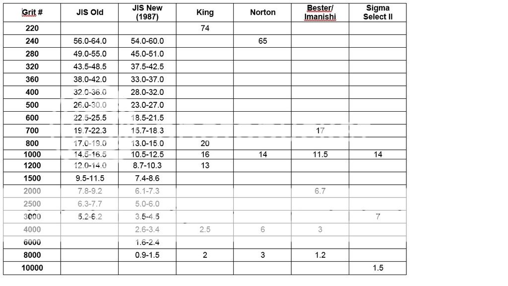

You're welcome. Here's a grit size chart for some popular brands. It's quite easy to make the jump from 1000 grit to 4000/6000 grit without any problems on common stainless steels. I've done this for nearly 20 years now and it works pretty well.
