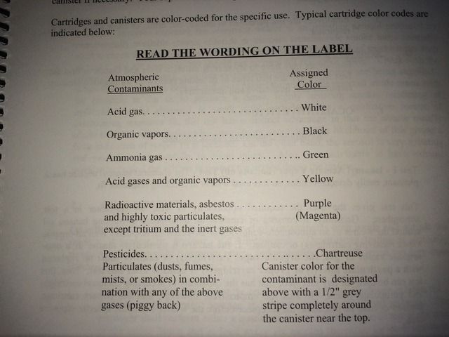

All are HEPA filtration to .3 micron. Basic filters have nuisance filters for light orders while carbon and organic vapor filters will keep out the worst of smells, VOC's, acid fumes and more. They offer ZERO added filtration so you should never mislead yourself into thinking they do anything extra beside filtering odor. All are still HEPA, some just with added features.
The carbon filters can get expensive (some more than a north resp) and additional care is needed with them. Once removed from their package they are only good for 7 days and that's only if you put them in a ziplock bag. In my experience they seem to last a little more than 7 days with proper care but simply not worth the added cost if all you are filtering out is particulates.

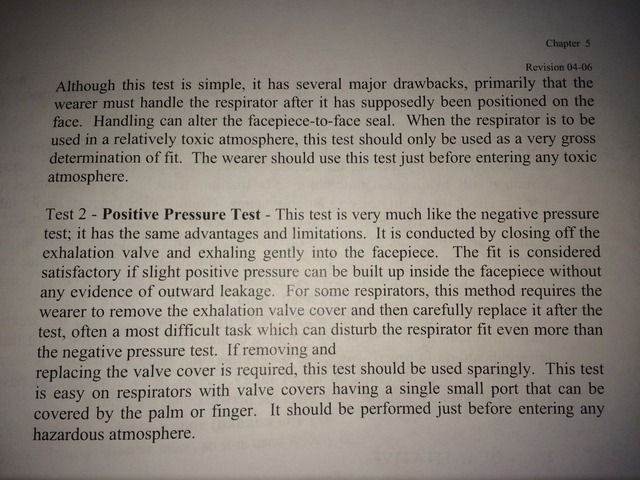

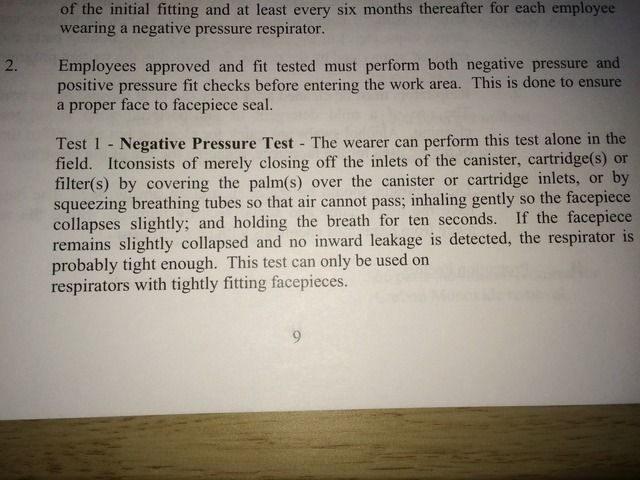

Here is some useful information,
