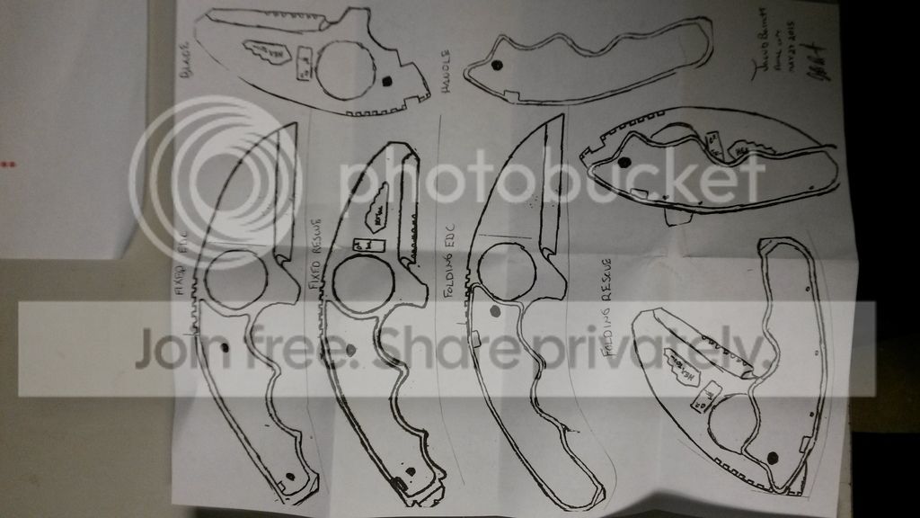

I am not saying this is your plan, I am simply stating thats why there are people questioning the validity of your idea. How about posting a design sketch to get some input. I am pretty sure you are safe from anyone trying to steal your design. The best advice I can give at this time is to make a working prototype, send it out for heat treat, and have someone test the crap out of it. This will tell you if the design is functional before you move too far into this.

Why are the bevels only twenty, twenty five percent of the total blade height ?

Why make the medic expose a live blade just to use the O2 wrench ?
If he's attached to a fire rescue truck, they have a literal truck load of prybars, jacks sledges, wedges and saws.
If you're going to use it, it's nice to has a narrow straight blade that can get into a small area and cut outwards.
the wide blade and humpy shape make it very limited in that respect.
reminds me of a Brous Silent Soldier. One issue is see is the large hole in the blade and the hex and oxy wrenches. If you plan to use the knife for prying in an emergency, they take too much meat out of the blade to keep it strong. They will be a real weak spot. Personally I would trade the finger hole for a good finger choil. Thats a personal thing, it will give a good secure grip, but could also trap a finger potentially leading to a broken digit depending on circumstances. The steep blade/handle angle looks extreme but could be an advantage in reverse grip when cutting seatbelts and such where the cut is made pulling toward yourself and not towards the victim.

If you're serious about making a responder knife then I would suggest learning how to make a folder. Then make a few until you are happy with them... Then sell them.

I think this thread shows how we want a knife to do a bunch of different things other than what a knife is intended to do. For the most part, everytime you add another function to a knife, all of the functions suffer. Take a great knife, add a screwdriver. Now you have a good knife and a servicable screwdriver. Add a bottle opener, and now the knife and screwdriver suffer more. A leatherman is a very good example. It does a lot of things "ok" but doesn't do anything great. I would stick with a nice knife that does, as a medic, what you need a knife to do. Carry a good knife and a multi-tool and you have most stuff covered. Just my $.02.
