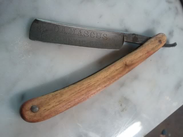

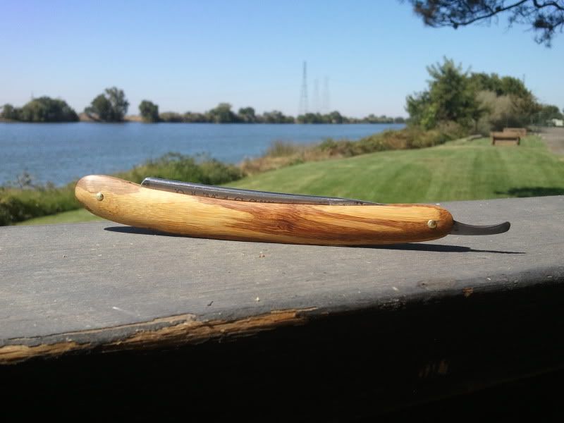

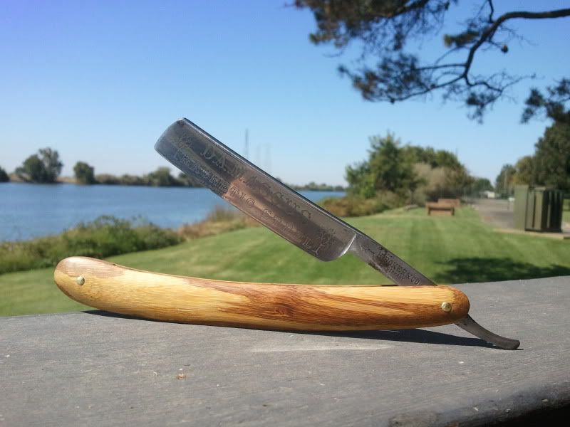

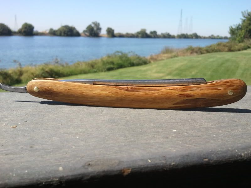

Well some others over in shop talk said they wanted to see this one when I got it done, so here it is. I say damascus because that is what is etched on the blade as an advertising gimick. The blade is made by H. Böker & Co in Germany and to the best I can find no later than 1924. The handle was poorly done with some soft wood, no wedge, and nails for pins. It worked but wasn't pretty. I cleaned up the blade, but left some minor pitting and patina staining to show the age. Still needs to be sent out for honing to be shave ready. The new scales are made from bamboo hardwood flooring. I cut a slab bookmatched and trimmed it down to 3/16" thick. Finish is 2500# with a light buff. Nice thing about the flooring material is it is made from many strips compressed and glued so no real finish is needed. 3/32" pins were left domed and hammer finished. Wedge is walnut from an old broken rifle stock.
This is how it looked when I got it...
And this is how it looks now...
Let me know what you guys think, and what you think I could do better on.
