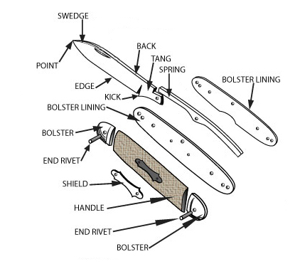

FixedBlade: Any ideas on how to get a file in to the small space to work on the kick?
I did find this nice diagram:
Ah, figured it out; will experiment.
