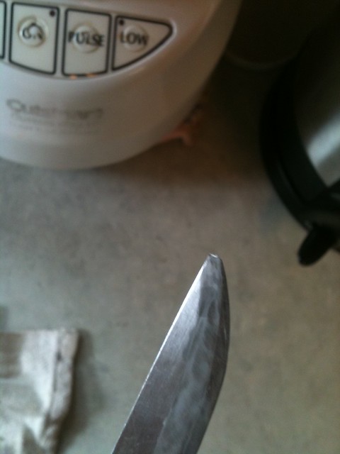

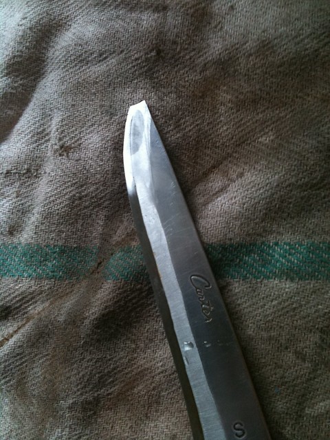

My roommates destroyed the tip of their Murray Carter (MS) paring knife and while they were out today I decided to fix it for them. You can see the knife before I started my work here:
Working on a KING #1000. My 'last molecule' that will eventually become the tip will be the top of the spine. I'll be removing steel on both the secondary and the primary edges to re-establish the tip. Compare the location of the shinogi (ridge line between the blade flats and the secondary edge) with the last picture and you can see how much of the secondary edge I ground back.
Slowly making my way up to the spine. 80% there after one hour.
The tip is restored, I've polished the secondary edge on the rest of the blade to even our the scratch pattern (next time I will make it more consistent and even), polished on a KING #6000.
The total project took about two hours to complete, but it was well worth it to have this knife back in the drawer shaving, pin-point sharp.
Thanks for looking!

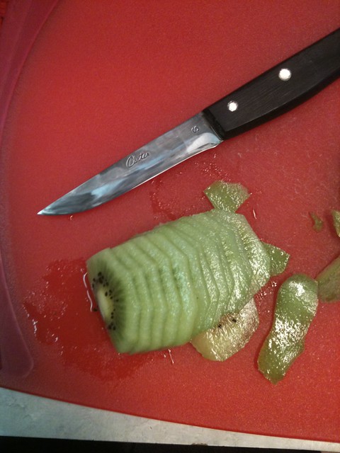

So after much youtube viewing and reviewing the 7 step process from Carter's mailing list, I decided to give his method a try on my Food Network damascus kitchen knife. Being damascus, full flat ground, and only needing a sharpening and some dishwasher chips taken out, I did not work on the secondary bevel. I did start on a coarser stone, the green 220 waterstone on my King 220/1000 combo stone. A few cuts into the edge of the stone took out the chips. Then I reset the bevel, gave it a few high angle deburring passes (the burr was very large and basically unaffected by drawing through the board). After this I moved to the 1000 side and continued, this time deburring on the board, stroppping and deburring again, and maybe one more time. I don't quite remember. Anyway, I now have a 1000 grit finish that will treetop hair 1/2" or more above my skin. The polish is interesting, kinda hazy, but attractive none the less.
