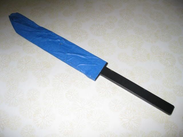

I took one apart last night to re-handle....it was put together VERY well!
The tang is .168 x .530 and of course, ran the entire length of the handle.
I'm planning nickle silver guard, and black micarta handle.

I'm wondering about the blade in this photo... How was the pommel attached? Doesn't the tang have a thinner part at the end to slide into it? Did you grind it off?
I have one ka-bar a part, I would get it fixed if I had better equipment.
The tang is solid bar like that, and the pommel is attached to the tang by a pin. And trust me, it's damn well put together. I'd say it's easier to saw part of the tang apart than getting the cap off. :D
That's a Roger, and that's exactly what I did....still plenty tang left for the handle design I have in mind....my guard material didn't come in today's mail:grumpy:
