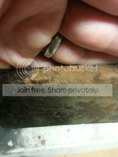

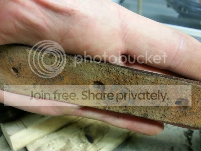

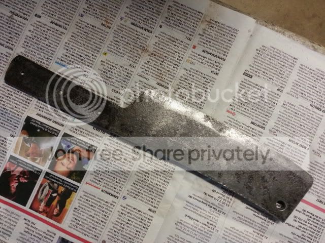

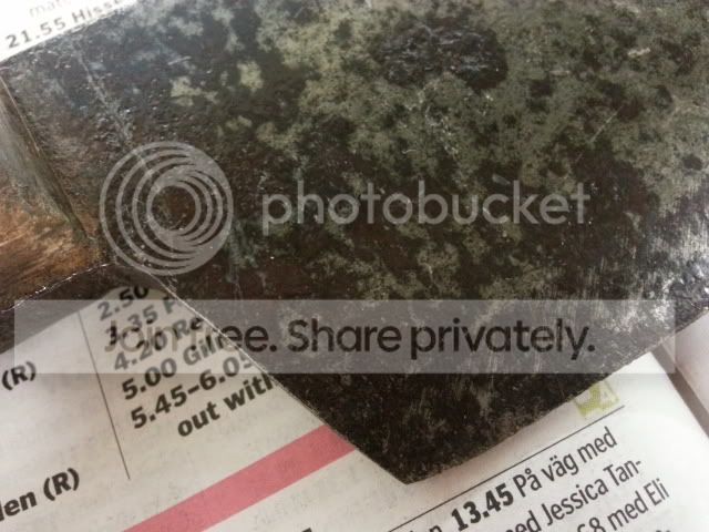

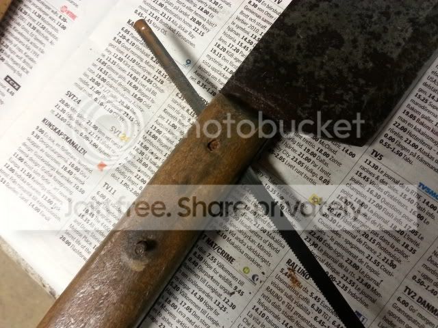

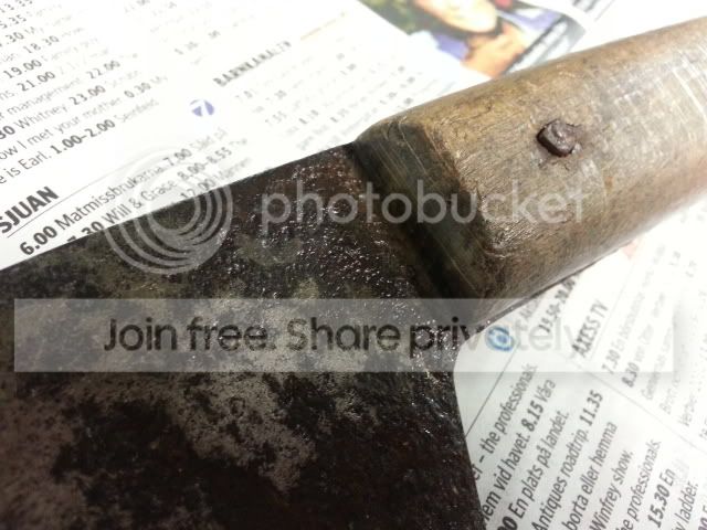

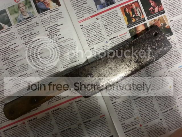

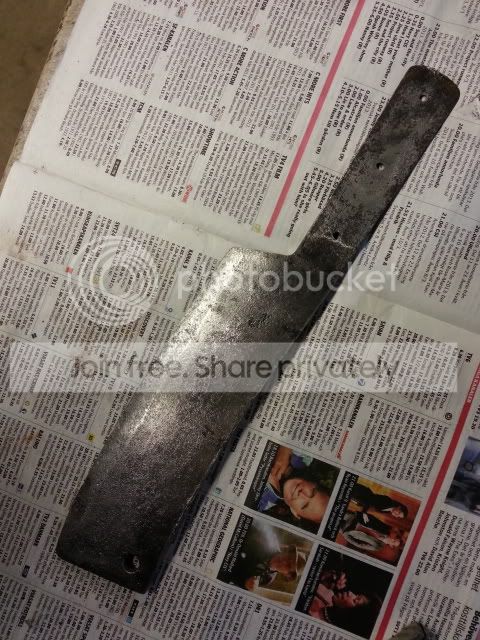

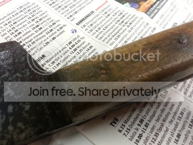

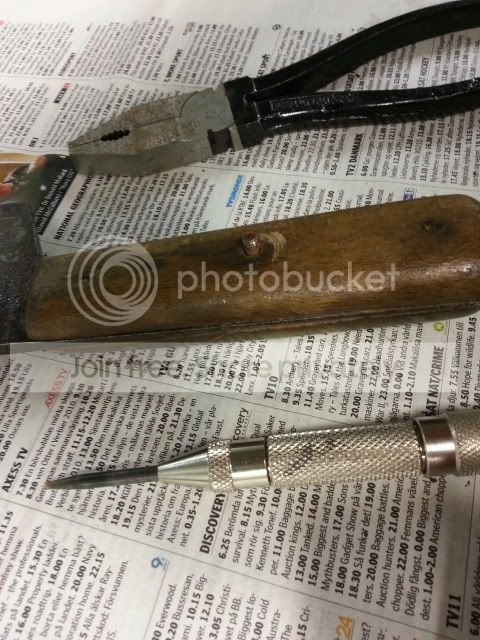

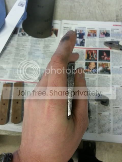

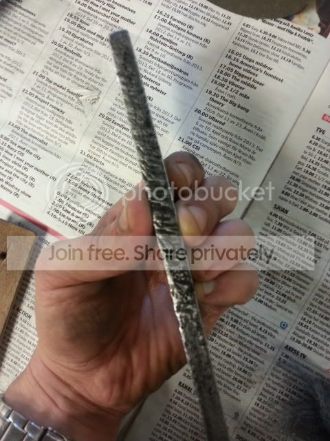

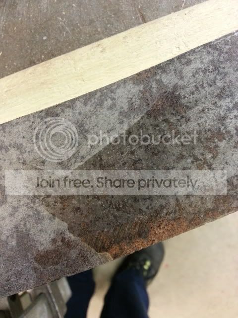

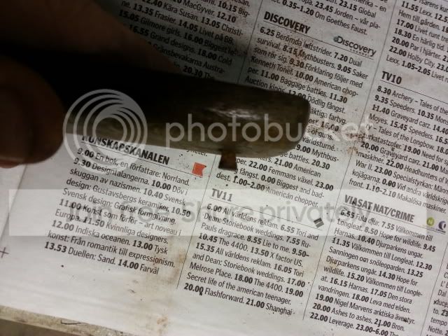

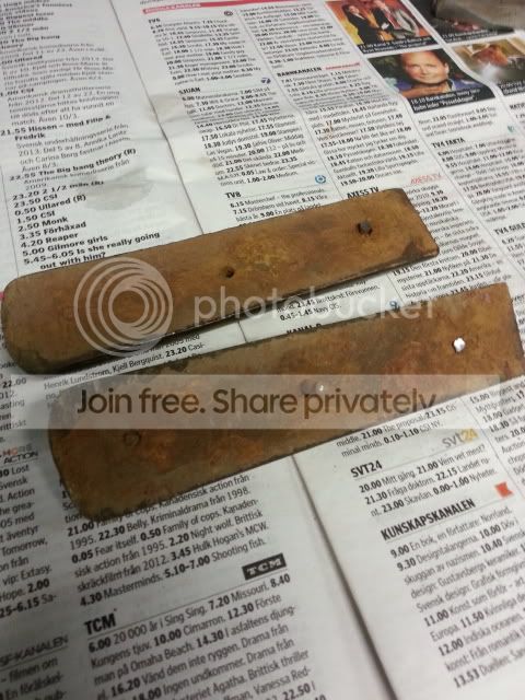

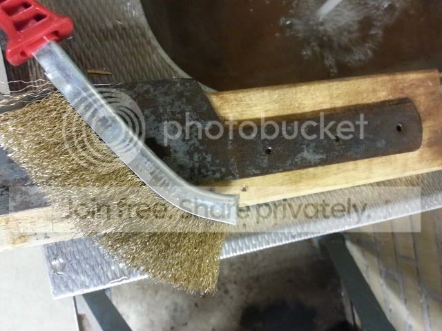

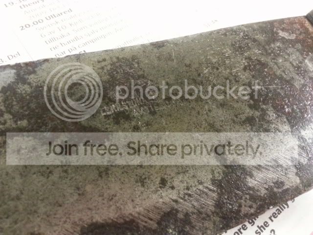

You know the deal by now. Found it for close to nothing. Beaten up, extremely tough black almost solid 1mm thick rust cakes. I think that some one as epxy coated the blade. :( On of the pins has rusted of the other two had com loose. Feel free to ask questions. :)

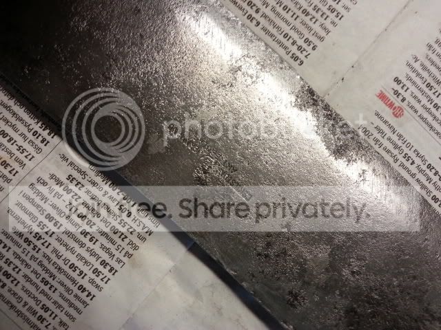

Acid bath 3x4h. Coffee machine cleaning liquid ph2 diluted 1:4. Gives black oily oxide and eats rust. The 6h clean up is almost finished.

Holy crap, that is a thick piece of steel!! Not sure I've ever seen a knife that thick. I love cleavers; I've always been drawn to them. Can wait to see your final results.
