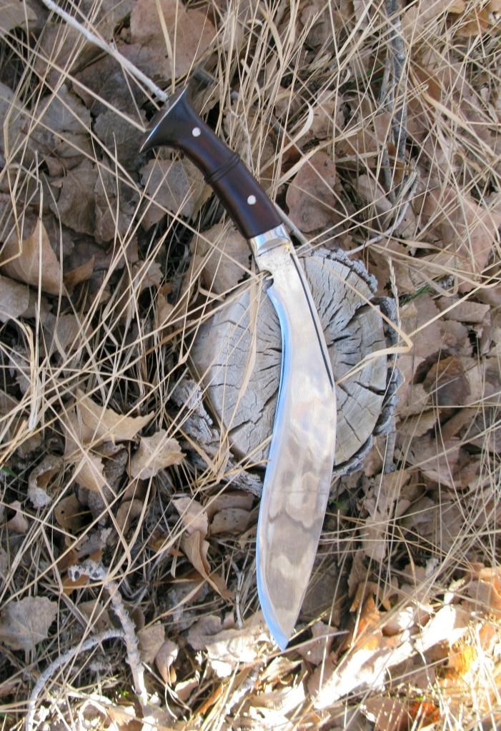

You could pour a bolster onto the handle and blade. Many original Khuks I've seen had poured bolsters on the. I've done it and long rifle chevron nose caps many times and is easy to do. You can use babbit, but high nickle content babbit, such as "Nickelite", looks much nicer and stays shiny longer. Here's a couple of photos previously posted as an example.
[/URL][/IMG]
[/URL][/IMG]
