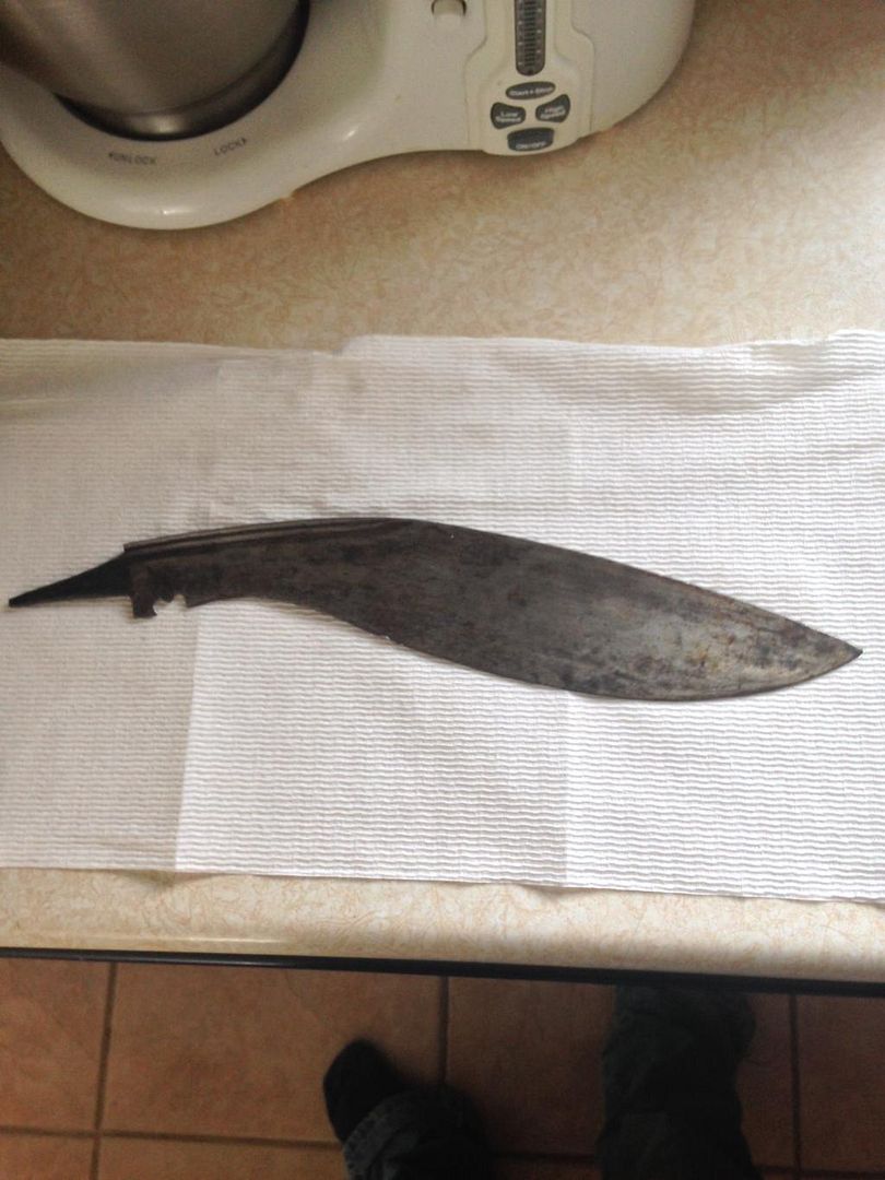

The blade is arriving tomorrow according to UPS but with the way this storm is hitting I'm not sure if work will extend past cleaning the blade off, might cut the maple to length for a handle.

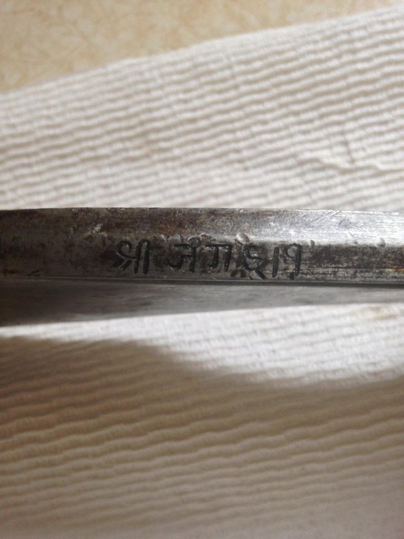

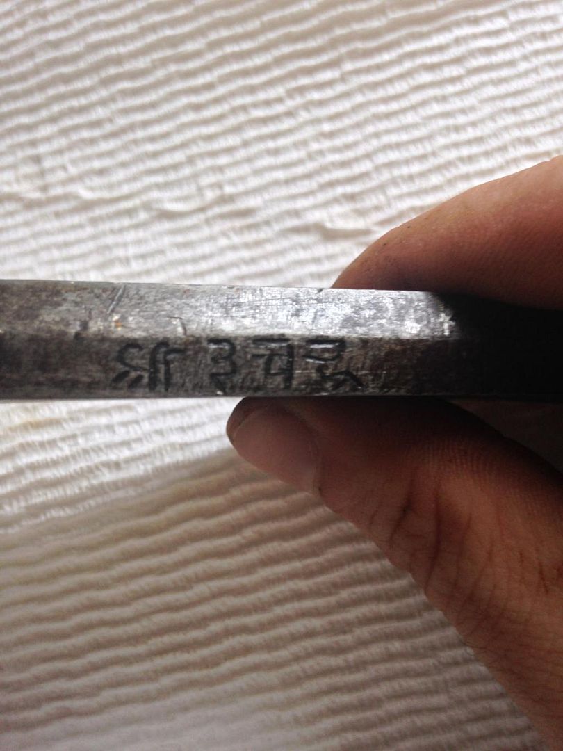

She's here, she's here! Think it may be a bhojpure, not a longleaf. Runs at about 17" unless I'm measuring it wrong. Might bring it up to them, might not. This monster is 1/2" thick with a 3" belly though so I'm not complaining. The tang runs just long enough for me to squeak a nearly full tang handle and it came with not one, but TWO sets of negari script, not sure if that's normal or not. The blade came in good shape since I didn't hand select, the spine has contact marks and the edge is dull but it's to be expected. Anyways I'll just shut up.
This script is near where the blade drops:
And this is near the tang.
Sweet! I think bhojpure too, doesn't look like a long leaf to me but I certainly ain't no expert.
I'd sure not complain about it and love it forever although don't the bhojpure's sell for a few bucks less than the long leaf's? Don't remember now. No worries, still wicked cool.
Now get to work and put a beautiful handle on that beautiful blade.
