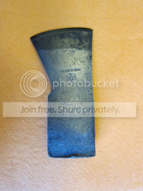

Restoring an old HB 0,8kg ax
Apr 14, 2012
663

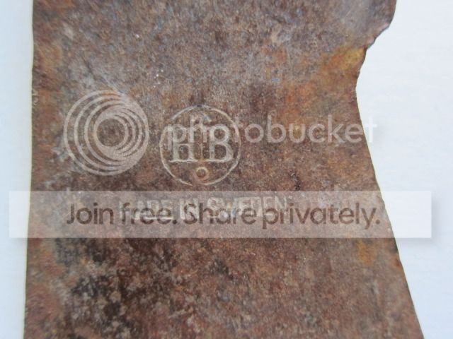

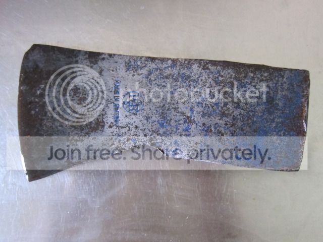

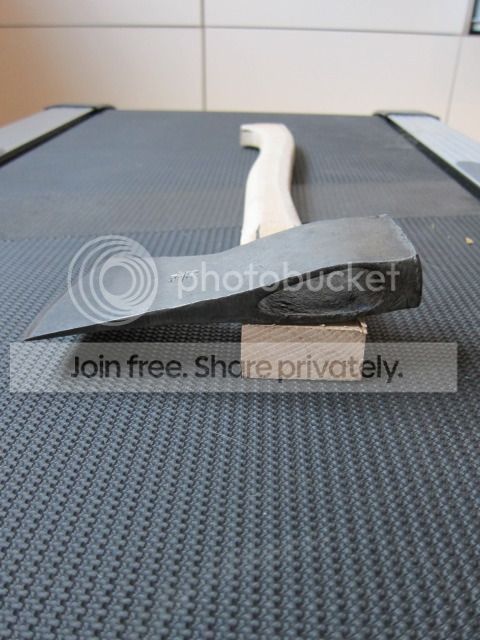

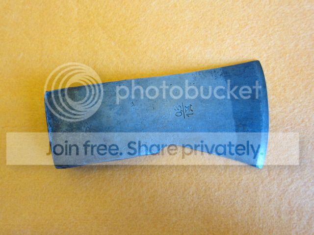

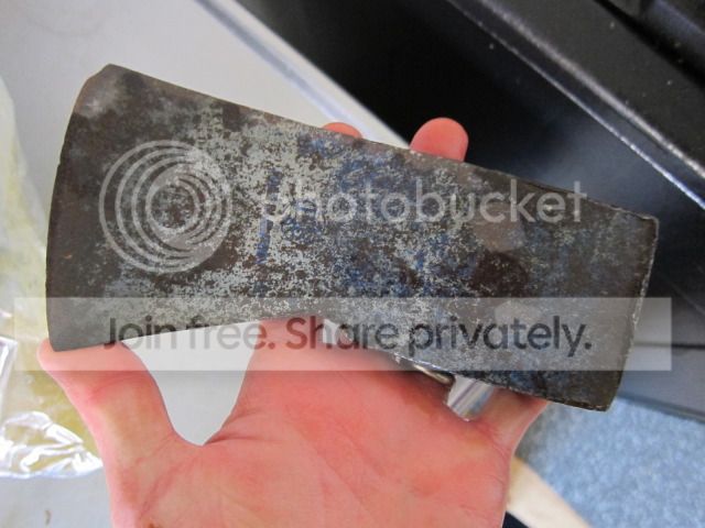

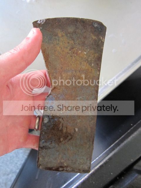

My grandfather was a carpenter and axeman. I cant remember seeing him whit out at least four out of the flowing five things. Classical morakniv, a Hults bruk adnor axe, a thermos of coffe, rubber boots, tweed cap.
I tried to get some of his axes of my father but lets just say the would not let go. :) So all what I got now is this axe head.

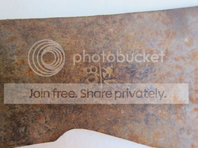

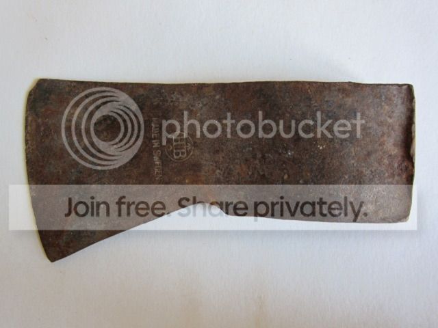

I'm not sure what to call it, forest axe maybe. The blade shape from above looks like a carpenters ax but the blade shape is more of a felling axe.
How ever I'm going to try to find that out and restore it. First step rust removal, second step new edge. After that I will have to make some decisions about the handle.

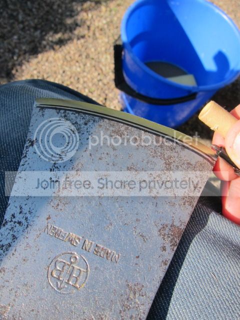

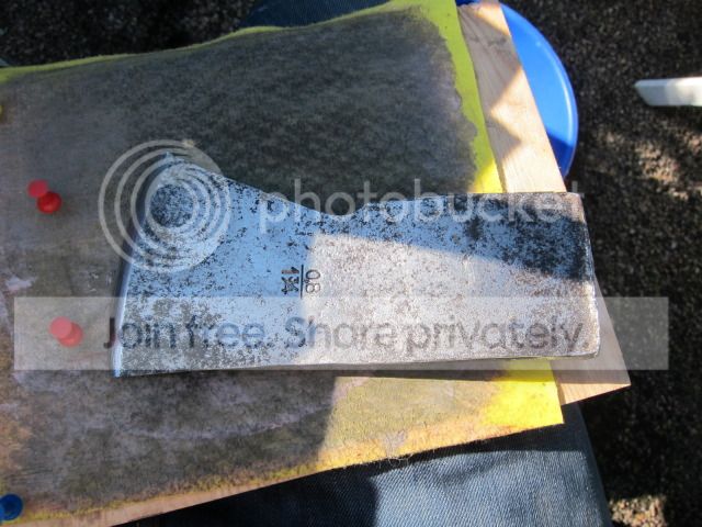

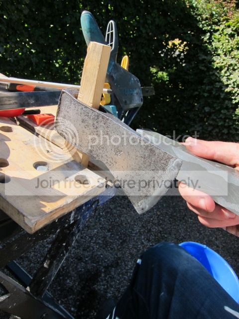

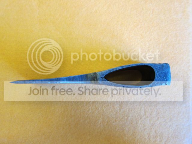

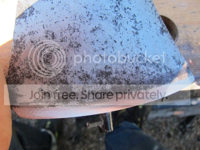

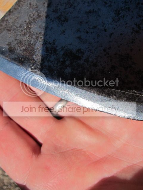

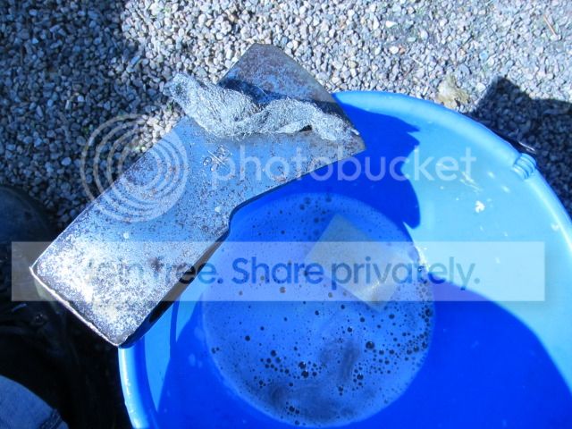

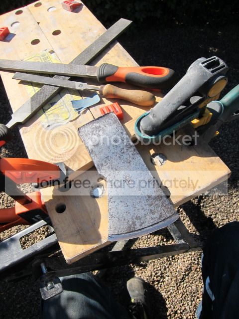

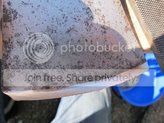

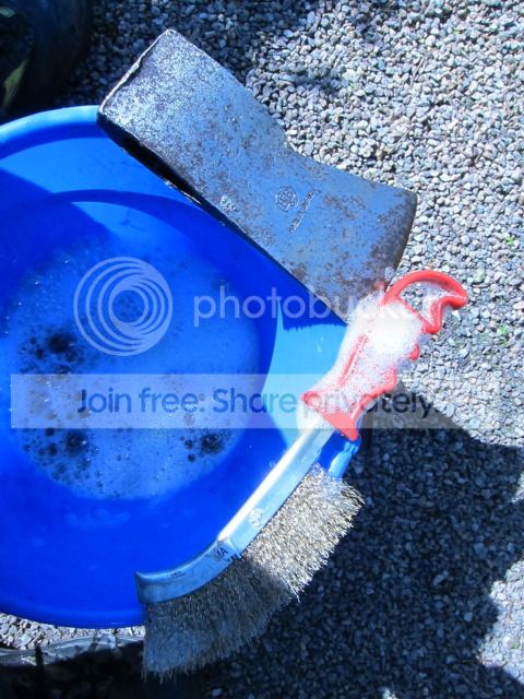

Ok. I learned lots of things today. The most visual is that the hot vinegar forced patina lifted the nice black oxide out of the pits. :( And showed of the hardening line. :( Otherwise everything turned out great.

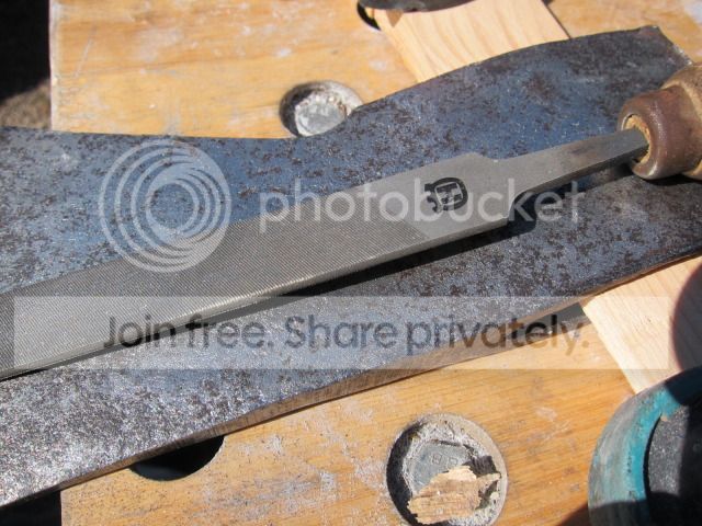

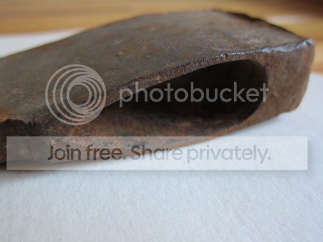

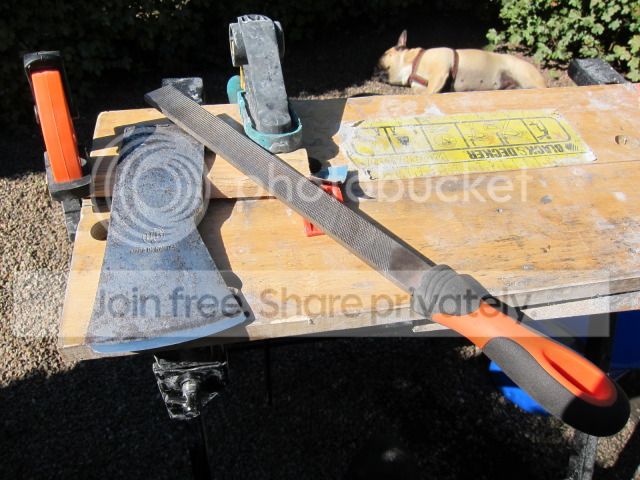

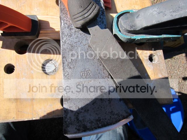

One the positive side. The inside of the "eye" is cleaned out and rust free. I managed to file it down. Keep the proportions and general edge geometry and put a shaving edge on it whit no jig. 90% of the work was done whit the bahco Öberg cut file and the husqvarna cheap chains saw file. That would be a good file to do maintenance work with.

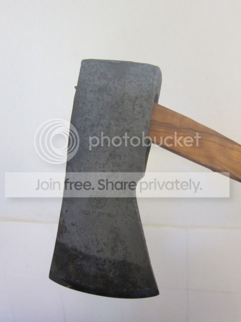

Thanks! This one is indeed going to be a working display piece!

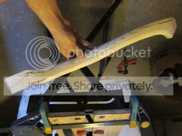

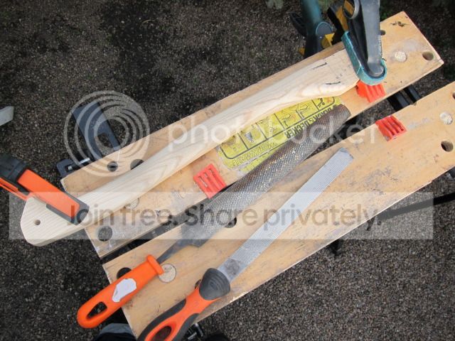

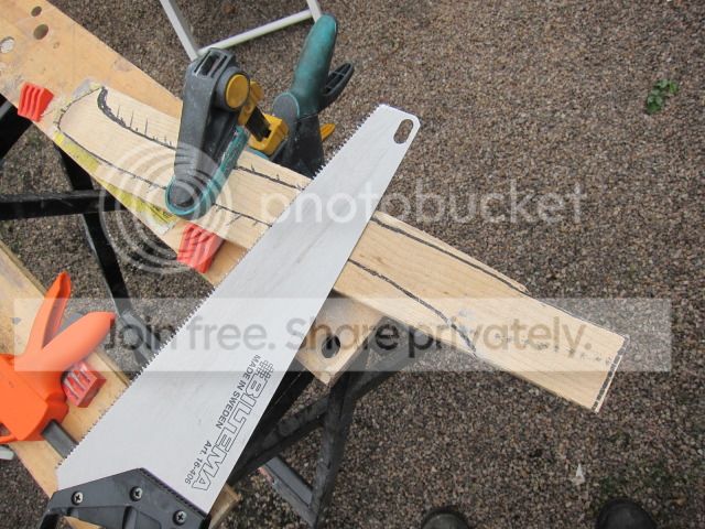

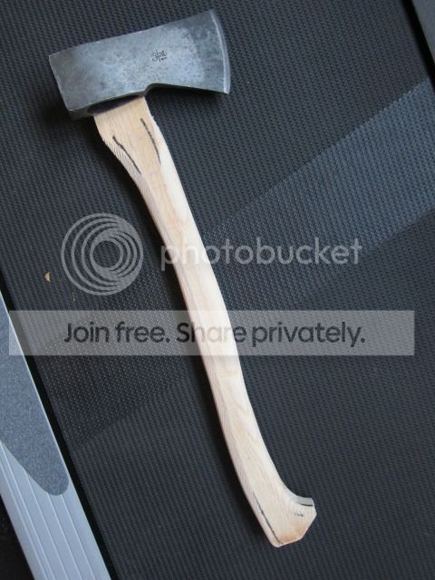

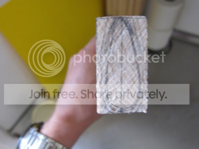

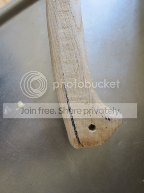

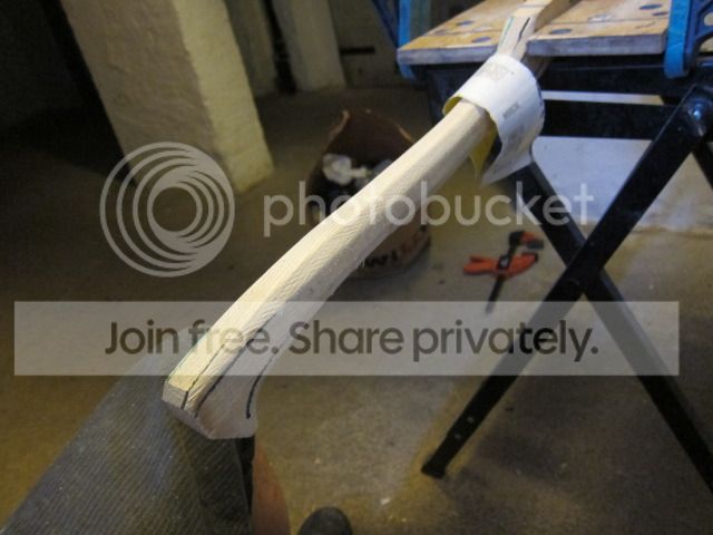

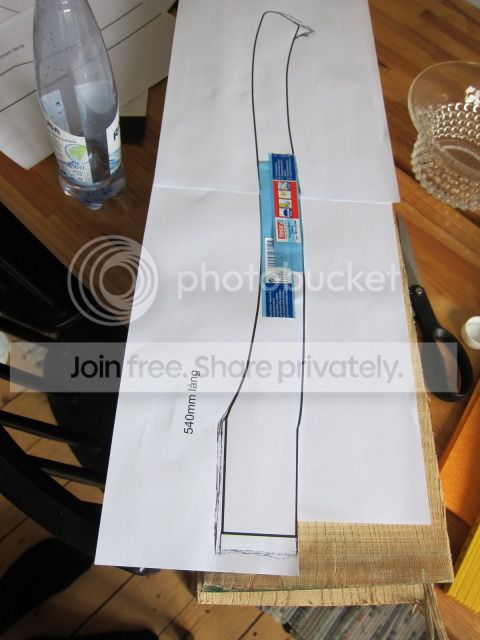

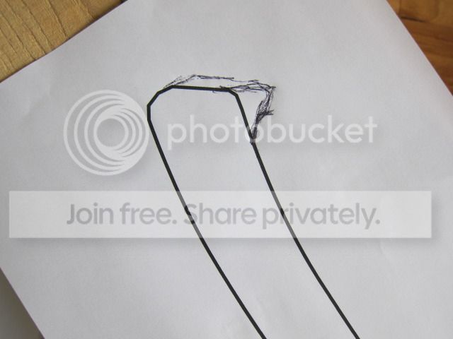

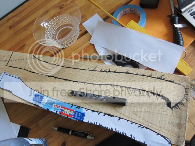

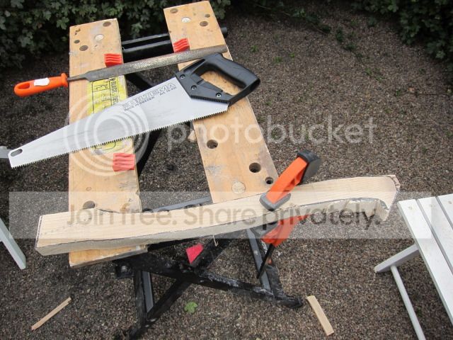

The shaft is 50% done. The work to day went far better than i could have hoped for given the tool I had available. Photobucket seems to have problems showing the pictures thou.
In shaping the ash wood the rasp and öberg cut file if far superior to the high quality 40 paper I bout. I think that if you had a half round file as a compliment you could almost put a rough finish on it this way.
