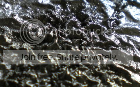

I used to do some reticulation with a super hot oxygen/acetylene torch and a pencil flame, which would give some wild looking textures in deep relief, but it’s hard to get a large piece nice and even, and without any holes burnt through it that way.
I started with a silver dollar and rolled it out. I figured I’d just keep rolling until it was big enough for the shape I needed (barely big enough), which came out to about 22-24 gage. Thin like that usually gives more relief and a better pattern. As I rolled it down, every time I annealed it I pickled it as well, which gets a good jump on the depletion silvering. After that, I repeated the depletion silvering a half dozen or so more times to get it nice and even. It’s better to overkill that part than under kill. I’m using my Map gas torch for the heat source,… same torch I use for silver brazing and fabricating. It has a nice bushy flame.
Yeah, reticulation is neat. Hoover and Strong used to make a special silver for reticulation, but the same method you just did has worked for centuries.
The principle is that by repeatedly annealing the silver and then pickling it, the sheet ends up with a fine silver outer shell over a .800 silver core. This is heated with a reducing flame to a red color, and then the flame is made super hot by turning up the oxygen and the gas down. This small flame is played across the sheet and causes the core to melt, wrinkling the still solid outer shell which has a higher melting point.
Speed, and intensity will make bold patterns. If anything goes wrong you get molten puddles.
I probably spoiled all the joy for Tai with that science talk...sorry.
Stacy, the science part is interesting and necessary to understand,... but I'm mostly interested in the textures. That link talks about some of the different ways of doing it,… the metallurgy, history etc.
It's like an aerial view of the desert where I live.
The plan is to do a whole handle with it in three sections.
That is a very striking texture! Seems to go against common sense, melting the inside but not the outside! Very nicely done!

Yes, it will come off with more pickling. It's just a couple places where I got it a little hotter and the core bled through the fine silver "skin" and oxidized. You can see how the higher temps., caused the pattern to gain more detail, but it was right on the brink of melting ... we're talking a fraction of a second… just glad I got through all three without a meltdown.
On the final finish, I will patina it all black and highlight the reticulation anyway.
