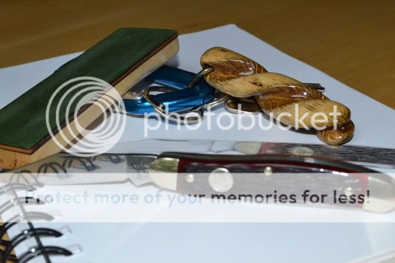

I've been sharpening for 30+ years (always loved knives, even as a kid) with pretty good success, achieving 'shaving sharp' pretty easily. Now, I've had a minor issue with S30v in that I can get it hair tree-topping sharp but it loses its ability to shave rather quickly. Even though it loses its shaving sharpness quickly I can cut cardboard for an hour or so before its working sharpness goes away and I feel the need to sharpen again. So, S30v has been a mixed bag. It stays working sharp for a real long time but I wish it would keep its razor edge longer.
Well, after reading some of the threads on S35vn (was looking for something that might hold the razor edge longer than S30v), the post by Anne that Chris had just made 300 cuts on orange extension cord and his Sebenza was still shaving sharp, it got me to thinking.
Chris (I believe) sharpens to a convex edge. I, using my Sharpmaker, sharpen to a flat bevel/micro bevel. When my Sebenza it tree-topping sharp, it is usually more so on one side than the other. I must be leaving a burr/wire edge on my Sebenza :foot: and this probably folds right over almost immediately, causing a loss of shaving sharpness, but given the wear resistance of S30v, it stays working sharp for a really long time. Chris, I am sure, does not leave a burr/wire edge when he's done sharpening.
How to solve this? Take the burr off with a strop. Last week I took an old belt, rubbed a bit of green honing compound into it and spent a few minutes stropping the edge. The edge is now tree-topping sharp on both sides, looks amazing under 100x microscope and will still shave after cutting a respectable amount of cardboard. I'm in heaven! I feel like I've hit sharpening nirvana.
Thanks for listening and I hope this helps someone else,
ThumperACC
