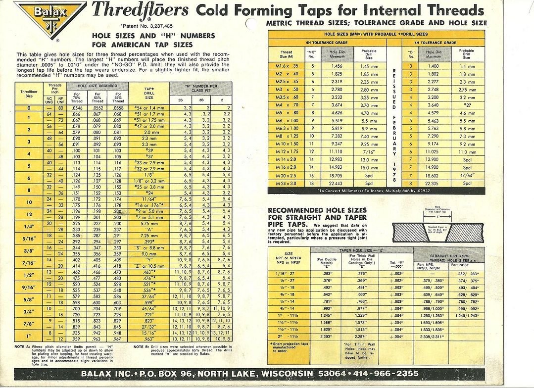

What size hole are you going to before you tap? Ti usually needs one size larger bit to tap well and will still be very strong. I use a chart that is specific to the actual taps I use and in Ti.
Helpful chart....
This is for thread forming taps, the numbers will work great on Titanium.

Forming taps in Ti, but the tap drill charts for cut threads are not valid for forming taps.
