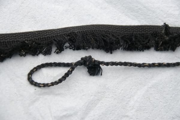

Another application - making cordage from unraveled clothing material or other fabrics, such as this cord made from unraveled jean material (denim).
Or this one from unraveled old dress web belt.
BTW, both these cords were used successfully for bow drill fire.
