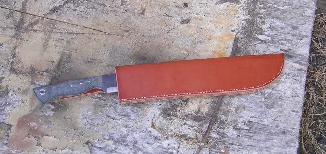

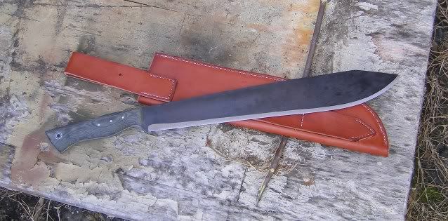

Here is the machete, and the wildman sheath. VERY HIGHT QUALITY sheath.

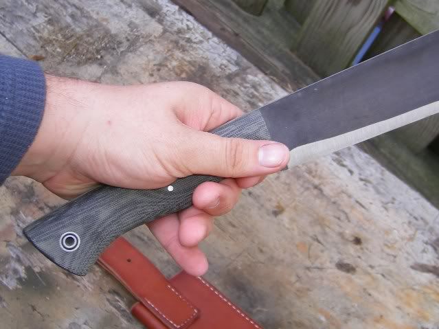

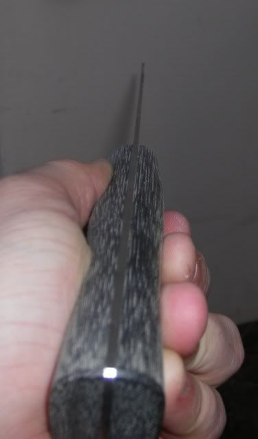

Machetes are used in a pinch grip. The top pic shows the cut out that allows that grip to be comfortable. Very well planned handle shape by Andy.

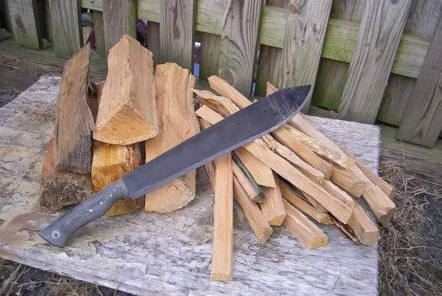

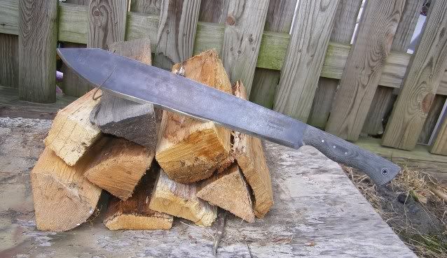

Here is the battoning test. This is not to test blade strength or anything like that, just to see how the edge hols up.

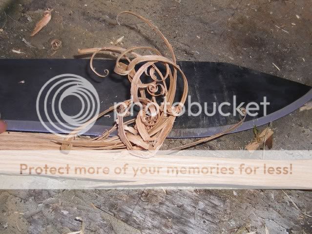

All battoning was done on the same 4 in section of the blade. After battoning that section was used to test sharpness. Plenty sharp for getting kindling started.

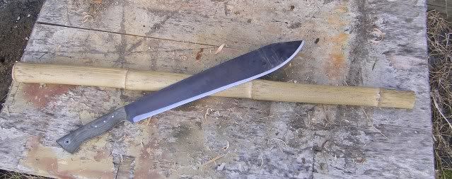

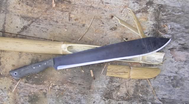

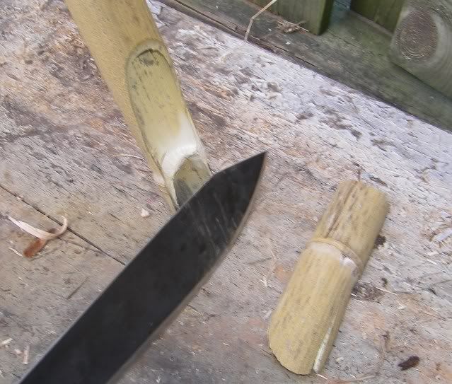

Next up was dried bamboo. I wanted to use a very light snap cut above the bottom node to see if it would split the node. It took only the strength of my fingers to flick the machete through the dried bamboo.

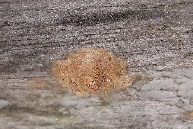

The tip was much more acute than most machetes. It drills very well, especially to make divots for a bow drill.

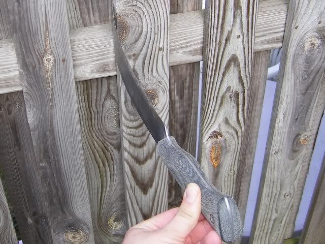

Last up, the flex test. Any good machete should have enough of a spring temper to deflect without breaking or taking a set. This one flexes easily and returns to true.

None of the slashing machetes I have used, including those in Nicaragua and Costa Rica, have had the handle cut out for the pinch grip.
I normally file/sand down a handle to get a shape that this comes standard. Nice. Any pics of the sheath?

I file down the side contour of all my machetes but its more effort than I'm willing to put in to file the metal tang that far.
This is the only other pic of the sheath I have. It is very thick and solidly formed.

I rather liked your review. Seeing the Fiddleback Split kindling then make fuzz sticks was really good. You make the same size kindling as I do for my mom's wood stove. That reminds me, I need to make mom more kindling. Maybe I should use my 12" Fiddleback to do it. Give me a chance to use it even though there still is tons of snow in the ground. :thumbup:
