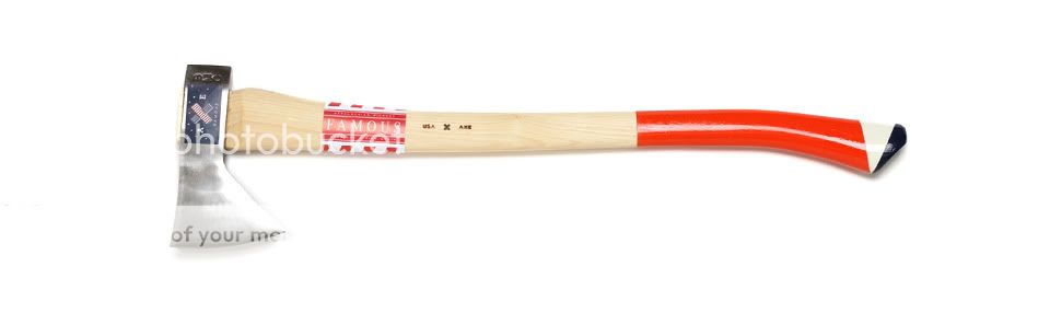

Smith's painted pieces have already attracted international attention, having been purchased by the likes of Mike Jones (president of Myspace) and are also on exhibit at the Saatchi Gallery in London. Here's an example of one of Best Made's painted versions of the Hudson Bay axe:

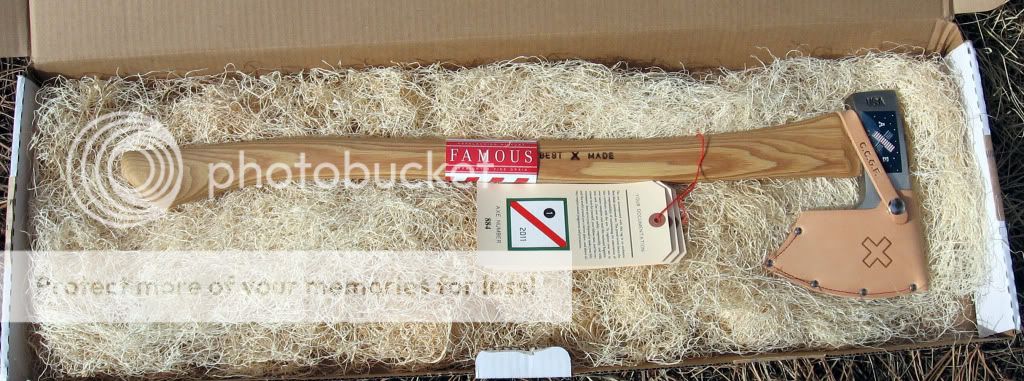

The Unfinished Hudson Bay Axe arrived in attractive packaging along with stylized information cards containing warranty info/registration, production number, axe maintenance tips and safety instructions:
The sheath is similar in style to those used on the Swedish Gransfors Bruks axes. This is not surprising considering that Smith visited the Gransfor's factory a couple of years ago and took note of their simple yet elegant sheath designs. On a longer axe, these sheaths tend to be easier to use in the field as compared to the top loading sheath on the shorter Council version. The strap also bears the "C.C.G.F." logo, which stands for Smith's outdoor credo; Courage / Compassion / Grace / Fortitude:

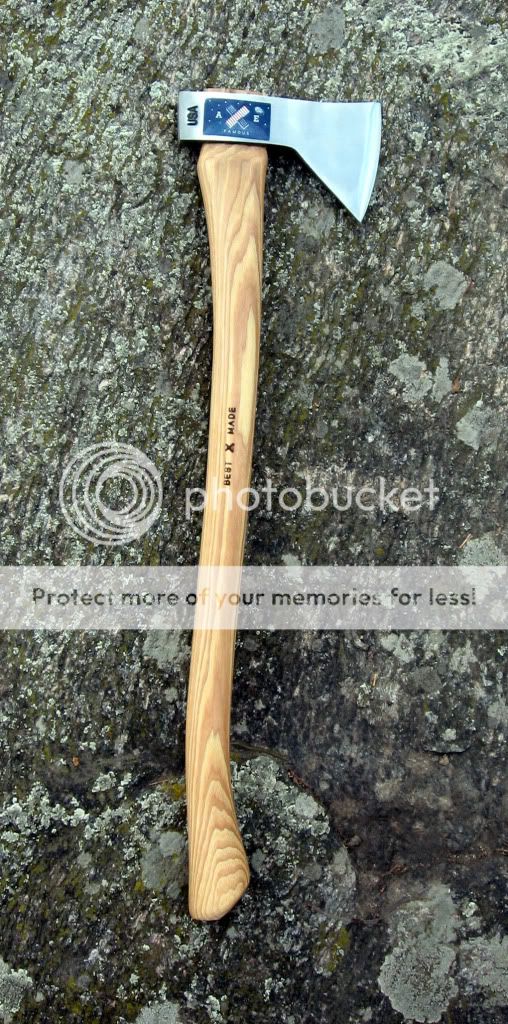

As mentioned above, the Best Made is basically a rebranded Velvicut Hudson Bay Axe with a longer handle and different sheath. Here's a comparison shot of the two side by side (Best Made axe on the right):
The overall quality of the handle, including grain direction and head/handle alignment is very good and similar to the Velvicut:

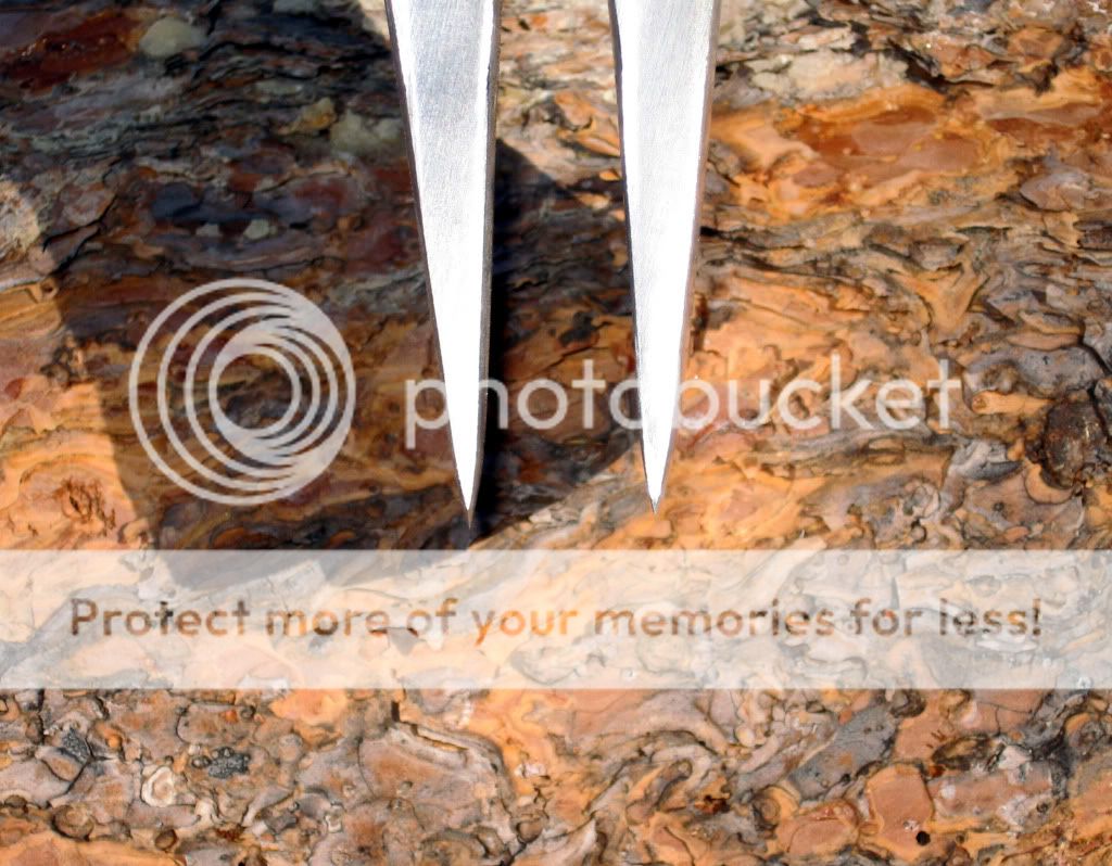

For the test, I thinned out the profile to get it as close to the Velvicut as possible. This particular model came with a thicker stock profile than the Velvicut did, so additional edge work was necessary to get the two to match for the test. This is not the fault of Best Made since Council Tool makes these, but hopefully Council Tool corrects this problem in their quality control process soon.
Here's a photo of the two axe profiles (after the edge work) side by side, with the Best Made on the right:

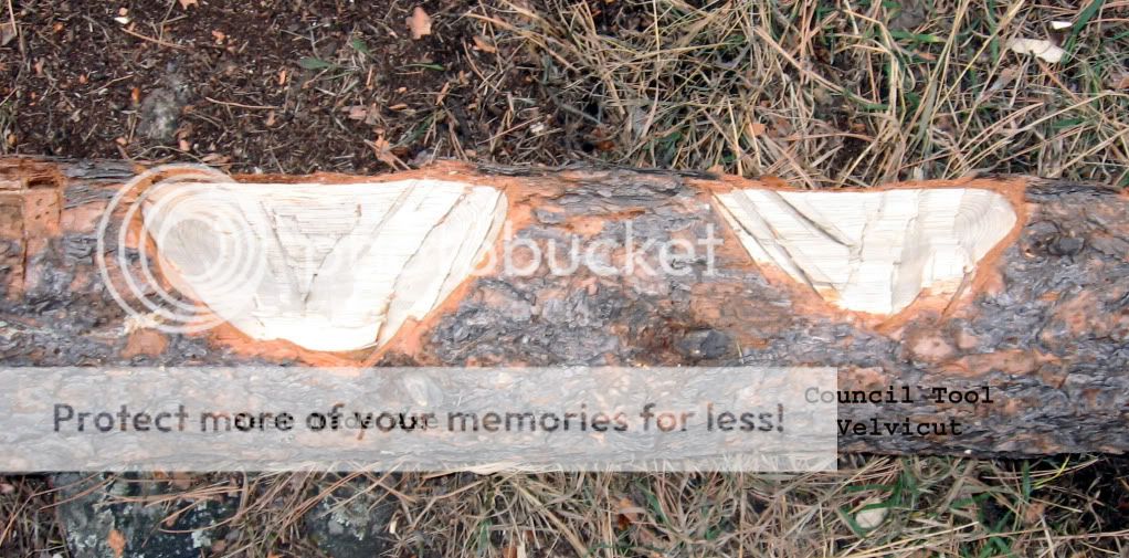

For the chopping test, I used a dry, seasoned Ponderosa Pine log and chopped 30 times with each axe. Due to the short 22.5" handle on the Velvicut, safe chopping required a kneeling position. This obviously reduces the amount of power in the swing. On the other hand, the Best Made, with its almost 4" length advantage, safely allowed for a standing position. This, along with the extra handle length yielded a rather dramatic result (Best Made notch on left):
The longer Best Made simply trounced the shorter Velvicut in the chopping contest. I was expecting a slight difference, but nothing quite this dramatic.

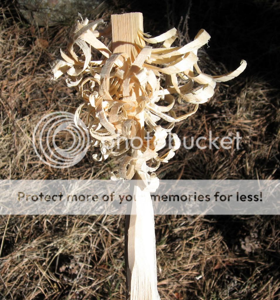

I also wanted to test out the Best Made's balance by creating some feather sticks. I had mentioned in my previous review of the Velvicut that I felt that the handle was a bit short for the weight of this head. After spending time using the longer Best Made, I have to say that it confirms my suspicions. The extra handle length just balances the axe better, and I actually found it easier to use for close work like feather stick making than the shorter Velvicut.
Feather stick made with the Best Made axe. The added balance of the longer handle definitely helps with this task:

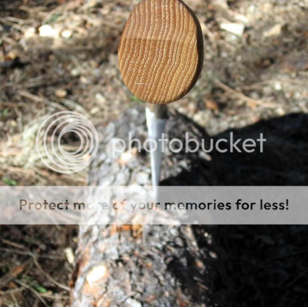

Now thats a product I can agree with, longer handle and way better sheath for only 5 dollars more, and if ordering online you are almost guaranteed a nice grain orientation.
Looks really good, but I have a question for Turbo: is the grain on the business end perpendicular to the head? I'm browsing on my phone so I can't see well.
