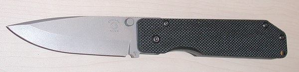

Im really looking forward to the drop point Strider. I believe I will like it more than the tanto.

DENNIS!! Ya BASTID!
Where did you get that picture?! I LIKE it. I had seen it before, but it has been a while. I LIKE it (did I already say that?)
It isn't yours, is it, ya bastid?!
I like it so much I thought it need to be in a second post.

Got the picture from equipped to survive. They seem to have some good info from time to time.

Uh, I just took a long look at the picture of the drop point strider.
Is it just me or does that blade look like a chisel grind?
What's up with that? A drop point chisel ground configuration?

Lenny, there are details of the drop point folders in both the Buck and Strider forums. I cannot remember any mention of chisel ground blades.

I wouldn't mind a chisel ground blade if it is done on the right side of the blade (yes, I'm right-handed). Other than marketing concerns, are there good reasons why we don't see more right-side grinding? Or is it only me who feel this way? Just wondering.
I seem to recall picking up one at Timonium back in December; I'm 99.99% certain that the drop point is NOT a chisel grind. Unless they changed it since then.
