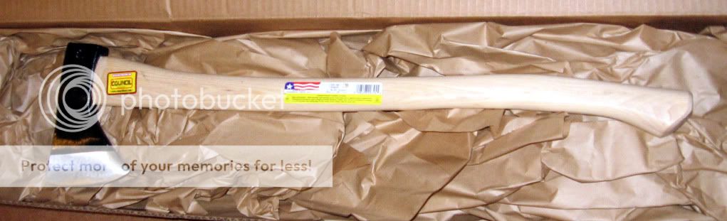

Council Tool 26" Hudson Bay Axe- Quality Wilderness axe at a firesale price​
Specifications:
  • 1.75lb Head
  • 26" Hickory Handle
  • Weight (without sheath)- 42.6 ounces
  • Weight (with factory sheath)- 47.1 ounces
  • Unknown High Carbon Tool Steel head, estimated Rockwell Hardness in the low 50s
  • Warranty-None (Council does have excellent service though)
  • Made in North Carolina, USA
Before I begin the review, a little history on this particular axe :) It was originally purchased from online reseller Terra Tech last year for $33.95 plus shipping.
Unfortunately, after a couple of weeks of chopping the head started coming loose. To Terra Tech and Council Tool's credit they had me send it back to Council Tool via a prepaid UPS label and Council reseated the head with a traditional wooden wedge and metal pin (these originally come from the factory with an aluminum wedge). It also appears that some sort of glue or epoxy was used to further reinforce the haft\head junction to ensure that it wouldn't come loose again. The axe was then sent back to me free of charge.
Having used the axe agressively since then I'd say they did a great job of securing the head as it hasn't budged since. It also gives the axe a more traditional appearance ala' Gransfors Bruks' style, which I like.
