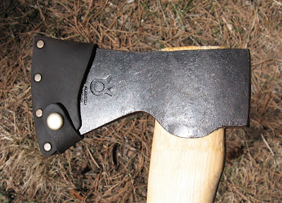

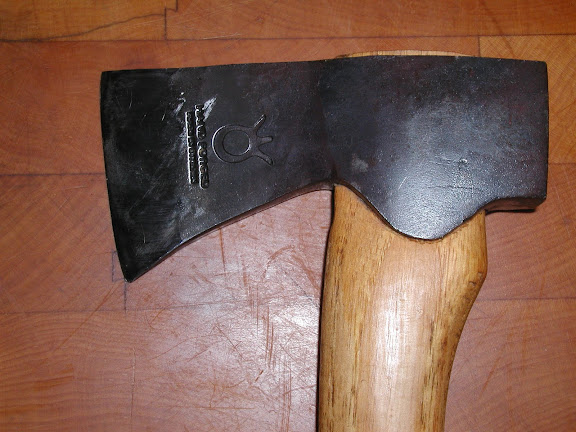

HEAD PROFILE
The bit on the Forest Axe came out of the box reasonably sharp, though not as sharp as most Gransfors Bruks and Wetterlings axes. However, the profile is very thin, so honing it to razor sharpness was easy and only took a few minutes.
(click to enlarge)
The cheeks are also a bit rough compared to offerings from the aforementioned axe companies, showing large grinding marks, etc. However, this didn't seem to hinder the performance of the axe, as you'll see in the field test below.

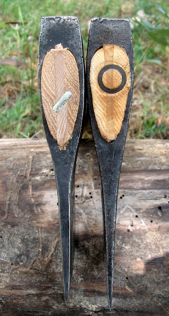

Handle/Handle Grain/Alignment/Balance
(click to enlarge)

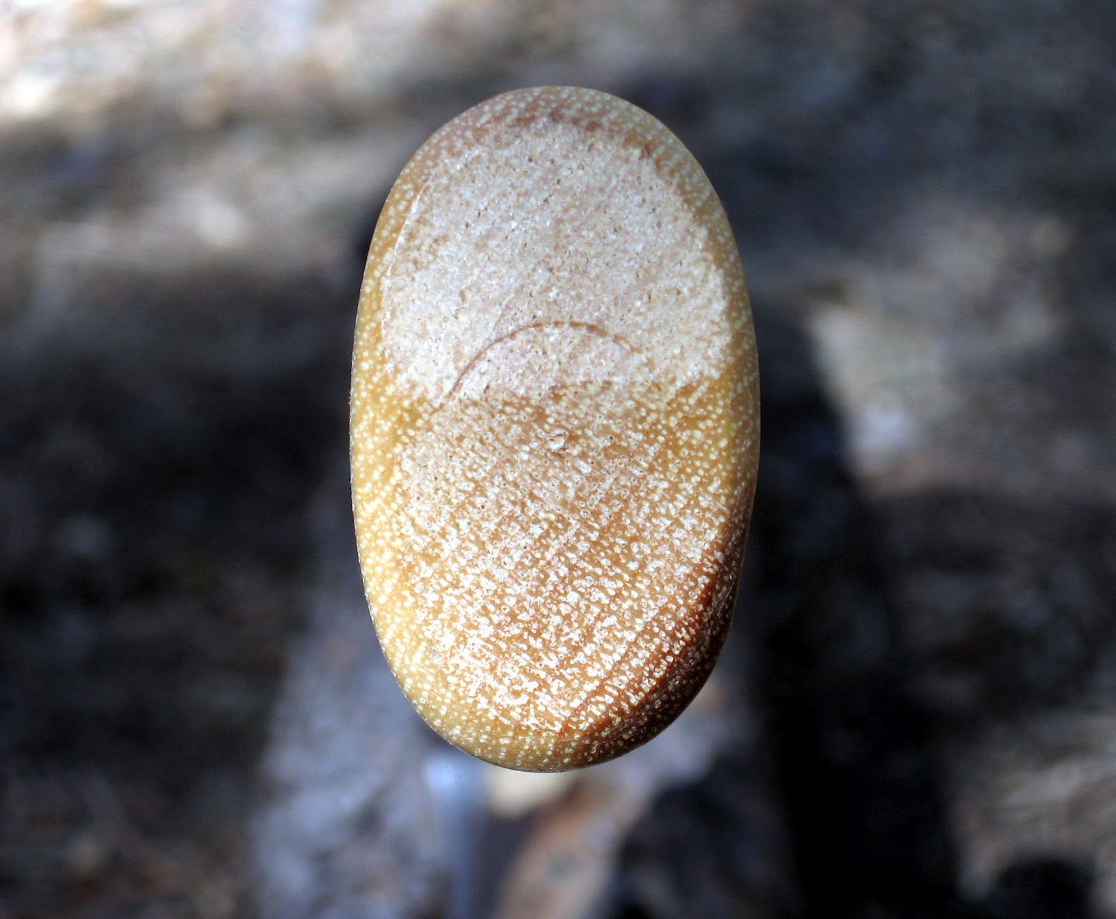

The handle came from the factory with a light coat of linseed oil. It is a little thicker than the handles on Gransfors Bruks or Best Made/Council Tool axes of this size, which I initially thought would make it rather bulky and unwieldy. After using it a bit, I was pleasantly surprised to find that I preferred it over the other handles. It is thick, but the way Hultafors profiles the handle makes it feel comfortable and secure in the hand.
The direction of the handle grain on this particular model is above average, and the tightness of the grain is excellent.

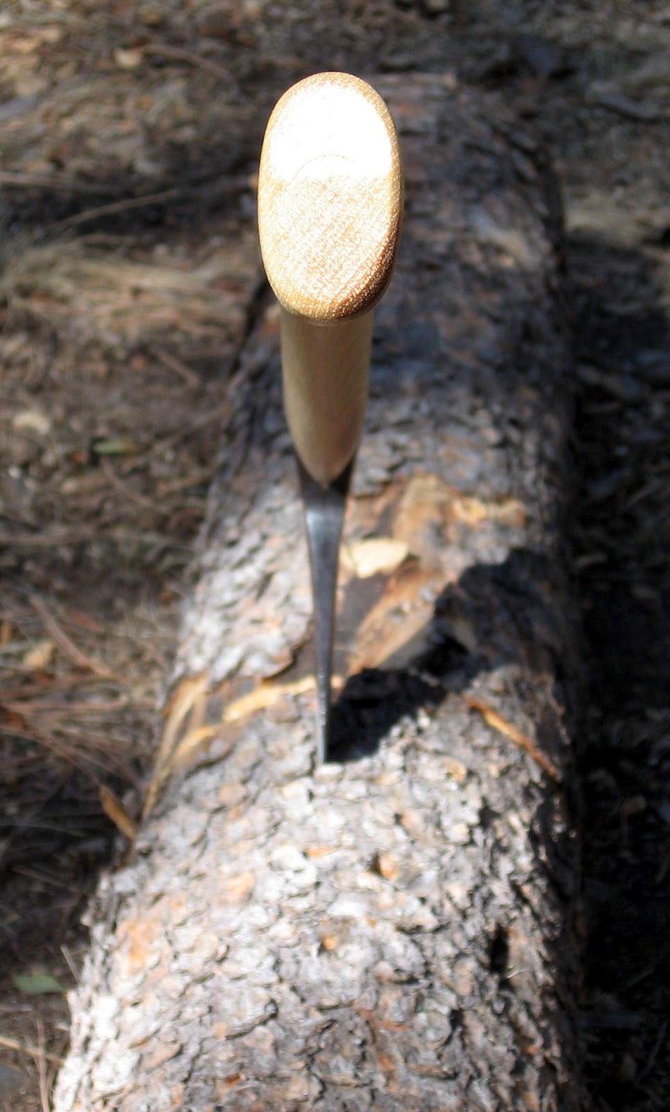

The alignment is almost perfect:

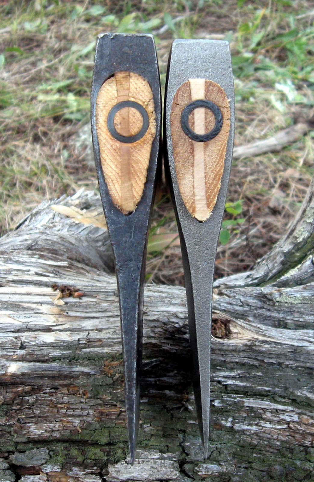

The handle is pinned to the head with a traditional wooden wedge and reinforced with a circular metal pin-style wedge. With the exception of a small gap at the four o'clock area of the eye, the overall quality of the head/handle joint is excellent. Over the course of 6 months of regular use, the handle stayed secure and never budged.

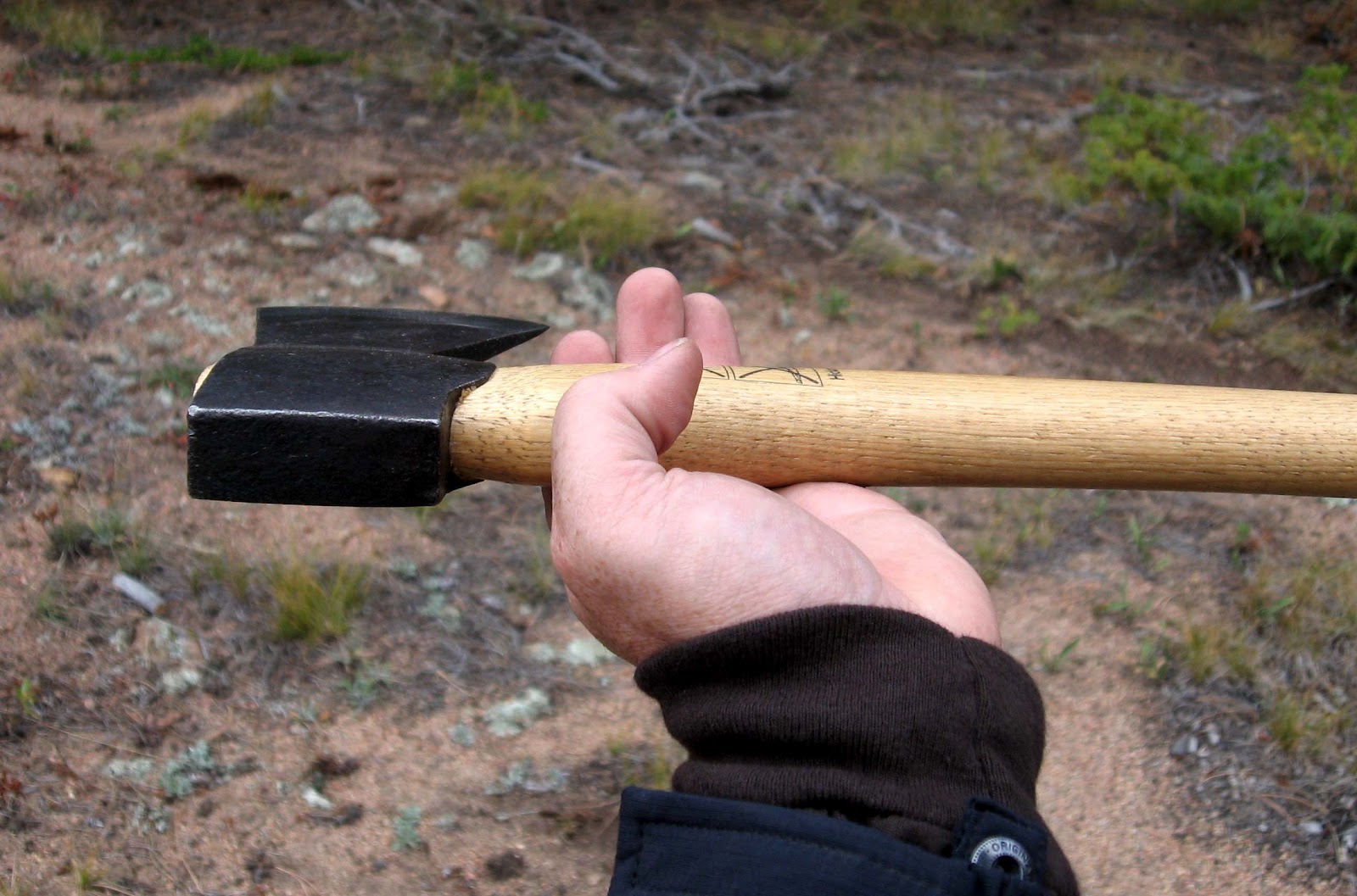

Using the Mors Kochanski balance test, the Forest Axe balances very well, with only a slight hint of heaviness in the bit.
(click to enlarge)

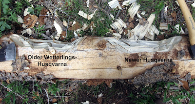

Forest Axe vs the previous Husqvarna Multi-Purpose Axe-
I felt that the older Multi-Purpose Axe had a slight advantage, owing to it's heavier head. The photo doesn't convey this advantage very well, as the Multi Purpose Axe chopped as deep as the Forest Axe even though the area that I chopped had more knots. Winner- Older Husqvarna Multi-Purpose Axe

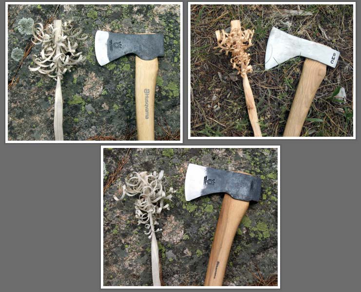

FINE CARVING
The thin bit on the Forest Axe makes it surprisingly adept at finer work. I was surprised to find that it slightly out-performed both the older Multi-Purpose Axe and the Best Made Hudson Bay when making feather-sticks, as shown in the photo below.
(Note- the Gransfors Bruks seen in the chopping comparison was a late arrival, so it is not seen in the fine carving comparison below. But the Husqvarna did compare very favorably to the Gransfors in some last minute feather-stick tests that I performed)
(click to enlarge)

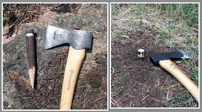

A tent stake carved from a dead Aspen branch, using only the Forest Axe (who says you gotta have a knife to survive in the wilderness!):
(click to enlarge)

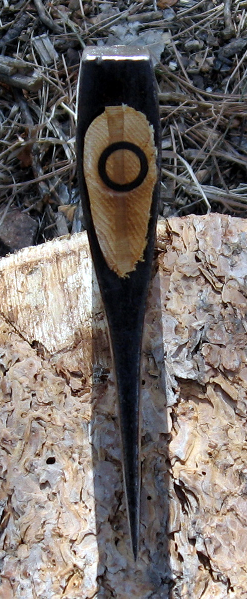

SPLITTING
My biggest concern with the Forest Axe was its ability to split logs, due to the thin profile of the head. True, it won't split with the ease of say a Fiskars X15 or a Council Tool\Best Made Hudson Bay axe, but it still split well enough to do a respectable job out in the bush.​
(click to enlarge)
Success!

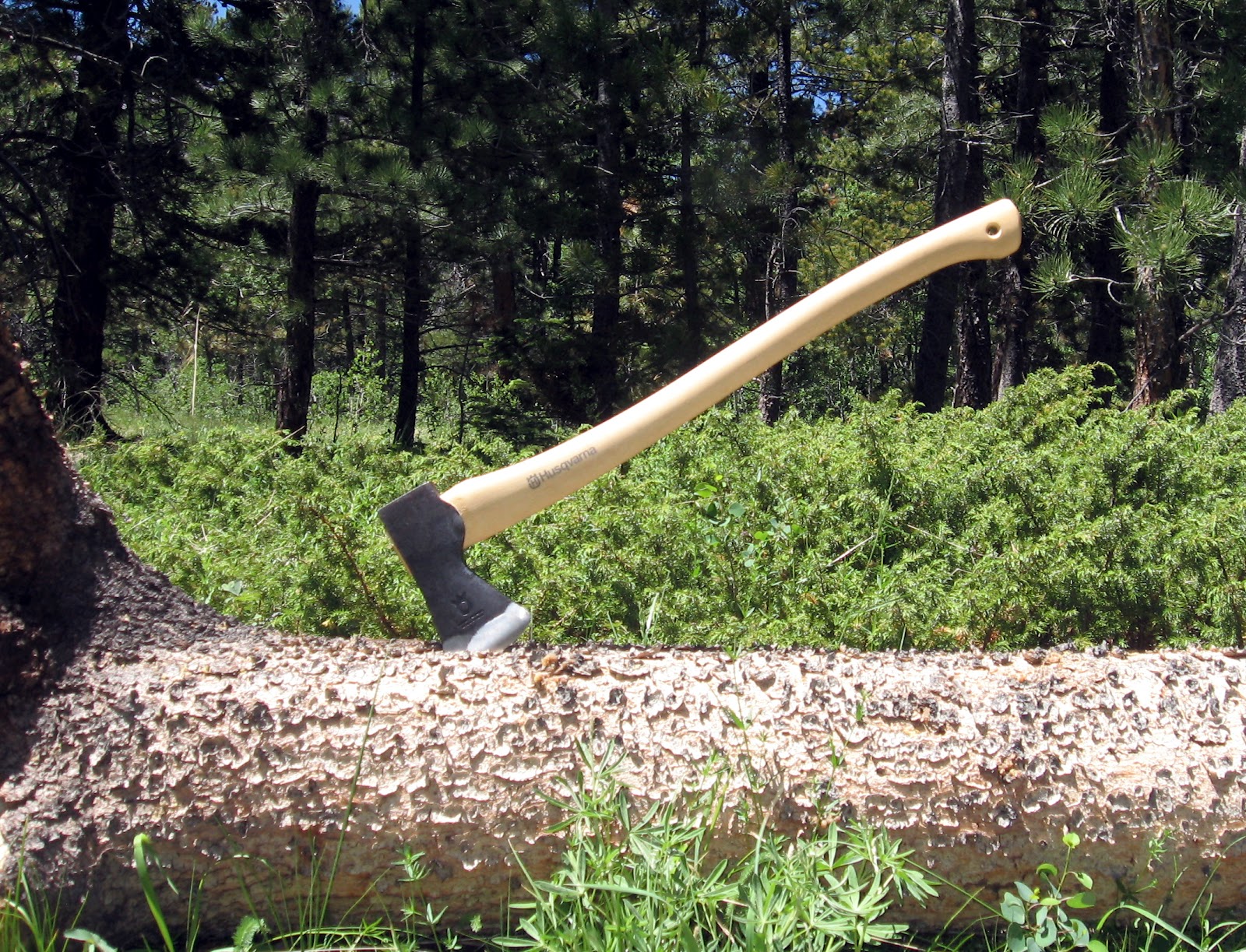

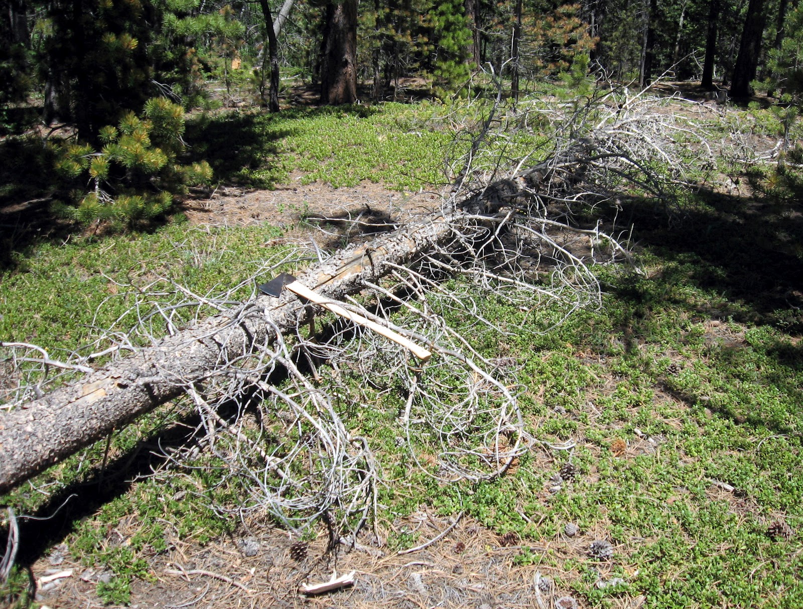

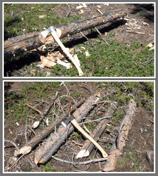

LIMBING
To test the Forest Axe's ability to limb a tree, I found a dead Lodgepole Pine, that had been blown over by a wind storm many years ago, and went to town. The Forest Axe performed excellently in this test.​
(click to enlarge)
I then bucked the limbed tree into sections. Once again, the Forest Axe performed well and made this job a pleasure.
(click to enlarge)
