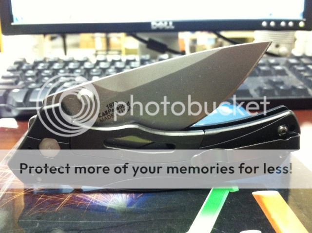

Review - Kershaw Knockout
Aug 10, 2012
6,586
Kershaw Knockout​
Specifications:
• Overall Length – 7.875”
• Blade Length – 3.25”
• Blade Thickness – 0.12”
• Weight – 3/8 oz.
• Handle Thickness – 0.40”
• Handle Length – 4.625”
• Framelock
• Drop Point blade shape
• Hollow ground
• Four-Way positionable pocket clip
Materials:
  • Black G-10
  • Stainless steel clip
  • Stonewashed 14C28N blade
  • Aluminum frame
Blade Centering:
The blade centering on this example was perfect. Right down the middle.
Lock-Up:
The lock-up on this example was just like the blade centering, perfect. I couldn’t detect any movement in any direction.
Construction:
I didn't take it apart, but the pivot uses a T8 torx bit. The body and pocketclip screws use a T6 torx bit. The Knockout also has a flow through design with the use of stand-offs.
Blade Shape:
The belly of the Knockout made food preparation a breeze. It also faired well in cardboard and whittling of wood.
Pocket Clip:
The Knockout has a black coated deep-carry clip. I was able to see very small wear marks on it, but those don't bother me.
Ergonomics:
The aluminum frame of the Knockout made deployment tricky. The combination of a hard firing flipper and slippery handles made it hard to hold onto. Kershaw did release a G-10 model of the Knockout, but it was discontinued.
Blade Steel:
The Knockout has a nice and subtle stonewash of 14C28N steel. This steel is one of my all-time favorites because It's easy to sharpen and takes a very nice sharp edge. It performed well and would still cut through phonebook paper after moderate use with wood and cardboard.
Deployment:
The Knockout is easy to deploy with the SpeedSafe it has and incorporation of the flipper. The thumbstuds also work well, but I found the flipper more comfortable and faster to use.
[video=youtube_share;ij30fCNZ5cc]http://youtu.be/ij30fCNZ5cc[/video]
Other Notes:
None! :D
Any questions or feedback is greatly welcomed! Thanks for reading!
Check out my other reviews here:
http://www.bladeforums.com/forums/showthread.php/1130120-Review-Kershaw-Rake
http://www.bladeforums.com/forums/showthread.php/1130139-Review-Kershaw-Piston
