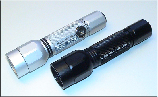

Part of the Black Knight series, the PM6 Lithium runs on two CR123 lithium batteries with a rugged body and far-throwing xenon lamp, but Pelican decided to take an already great light to another level by recently introducing the Pelican M6 LED. As you can see in the picture, the host body of the PM6 LED (bottom) is nearly identical to the original PM6. Currently the PM6 LED is only available in black, with silver bodies on the way.

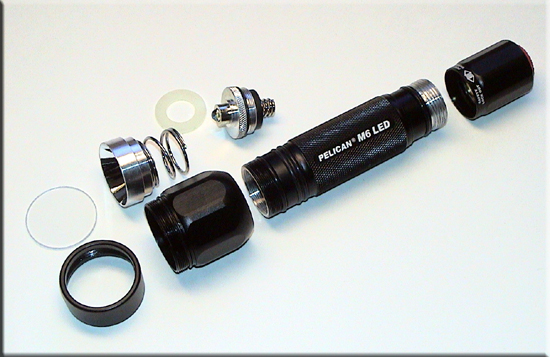

The picture above shows the PM6 after disassembly. The parts include the clickie (more on this later) switch housed in a lockout tailcap, the main body tube, the LED lamp assembly which screws into the body, a plastic washer, the reflector assembly with spring which is housed within the octagonal bezel, plastic lens and bezel ring.

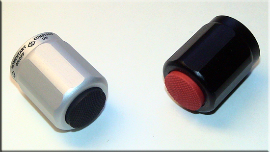

The tailcap is one of the improvements made to the PM6 LED. The new switch (right) is a clickie switch that is activated by pressing the red switch button on the tailcaplightly for momentary and all the way for constant on. The original PM6 used the button for momentary with the tailcap requiring rotation for constant on. The clickie switch is not very reactive (i.e. there is not much click to it), but it works well. The tailcap can be unscrewed to prevent accidental discharge.

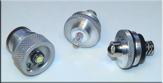

Here we see three examples of PM6 lamp assemblies. The assembly on the right shows the stock 1 watt (high dome) PM6 LED module, while the middle shows the PM6 xenon lamp assembly and the left module is a custom made 5watt McModule. While the bin code of the LED is unknown, the 1 watt LED of the PM6 LED is extremely white and bright and I have yet to hear anyone describe their own PM6 LEDs as anything but bright and white. Pelican must have been sitting on quite a large quantity of quality LEDs for this project.

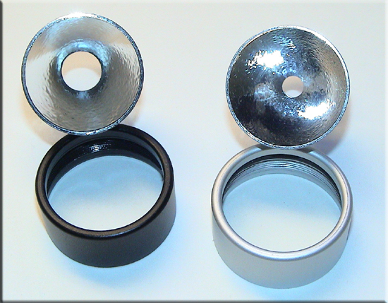

This next picture shows the difference between reflectors. The reflector on the left shows the larger opening for the PM6 LED while the left shows the smaller diameter opening for the original xenon lamp assembly. The xenon lamp assembly will work with the LED reflector but not the other way around. The PM6 reflector has been touted as one of the best reflectors out there and the PM6 LED just reinforces that idea.

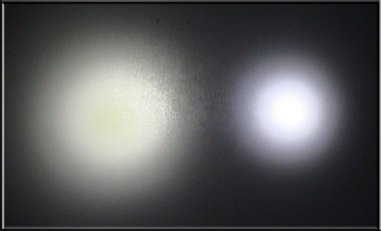

The left beamshot shows the PM6 xenon at its tightest focus with the PM6 LED on the right (tightest focus). As you can see in the picture, the LED is much whiter than the PM6 xenon which has a yellowish tint to it. The bluish tint is only apparent in the picture, when viewing the beam in person it is quite white. Both beams have quite a bit of useful spill that is not visible in the pictures. While the xenon lamp still appears to out throw the LED, the LED reaches quite far and it is doubtful that you will find a production LED light in this small a package that throws as far as the PM6 LED.
