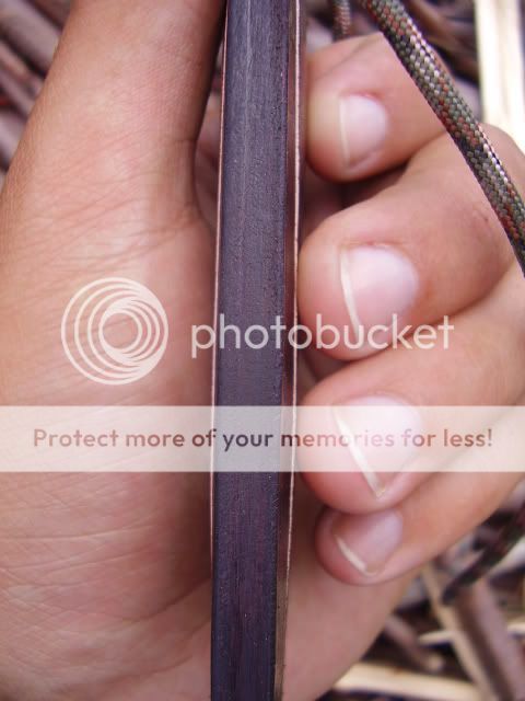

When I first received this knife I was shocked at its size, weight and thickness of the blade.
I did however carry the knife (and still am) for the December holidays.

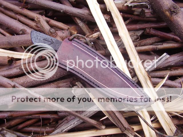

Here is the knife in sheath
Great workmanship on the sheath

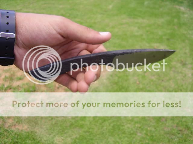

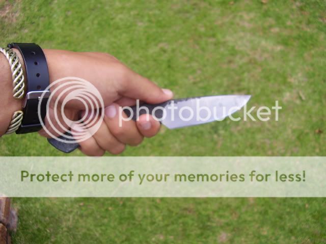

In hand
Balance point is at the second finger when gripped

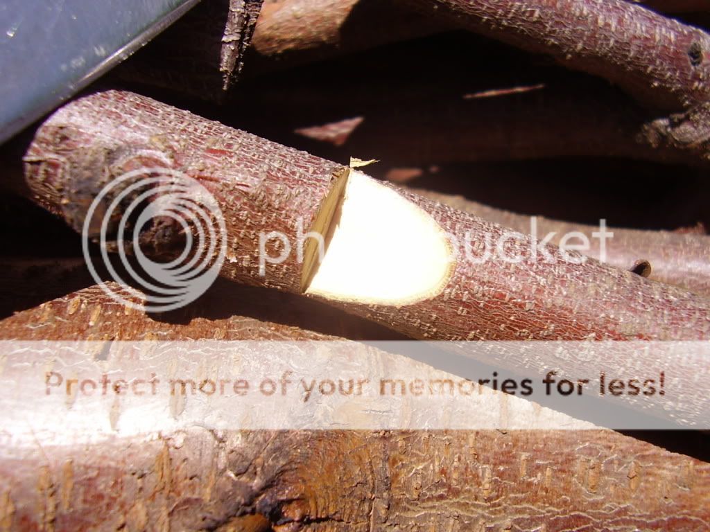

The reason why I carry a neck knife is due to its versatility and it can take more abuse then a folding knife. I do work in remote areas so I do consider the ability to carry a fixed blade as a luxury and a must have. One of the things I use my fixed blades for if I do not have an axe with me (rarely) is bushcraft. Rule of thumb is of course dont try and split a 10foot log with a 3inch blade. Use your common sense.

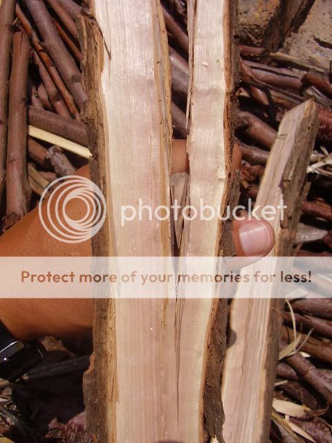

Split some wood:
Getting some smaller pieces from a piece I split with the axe, notice how the blade forms a wedge due to its thickness.

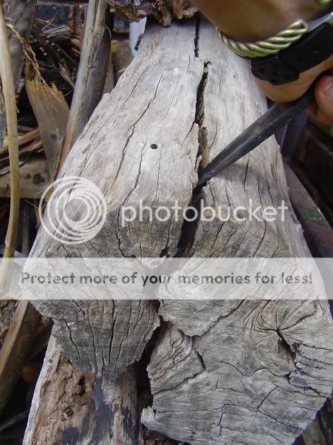

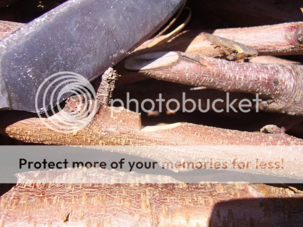

Went and found some old rotten tree limbs that one would break to get some termites.

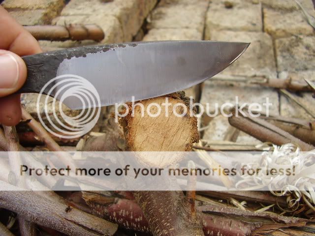

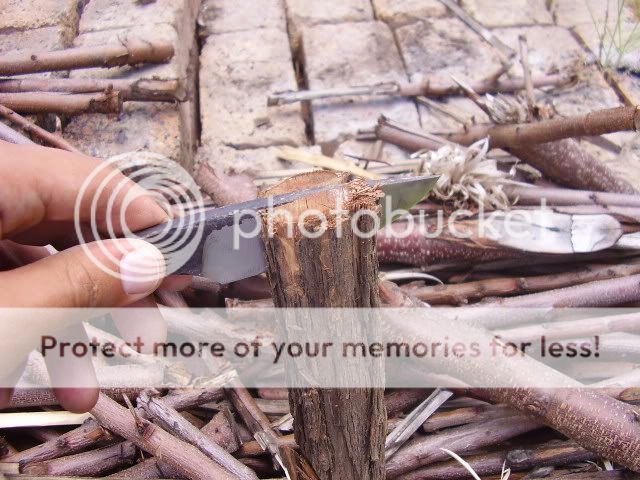

Notch work for traps

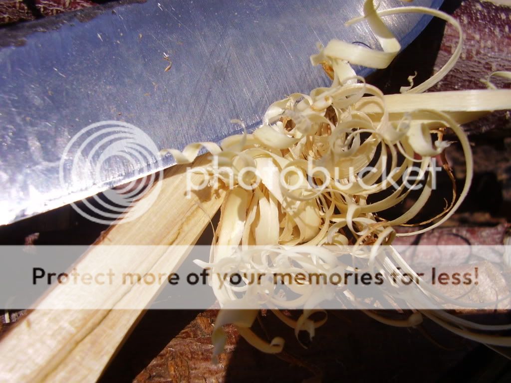

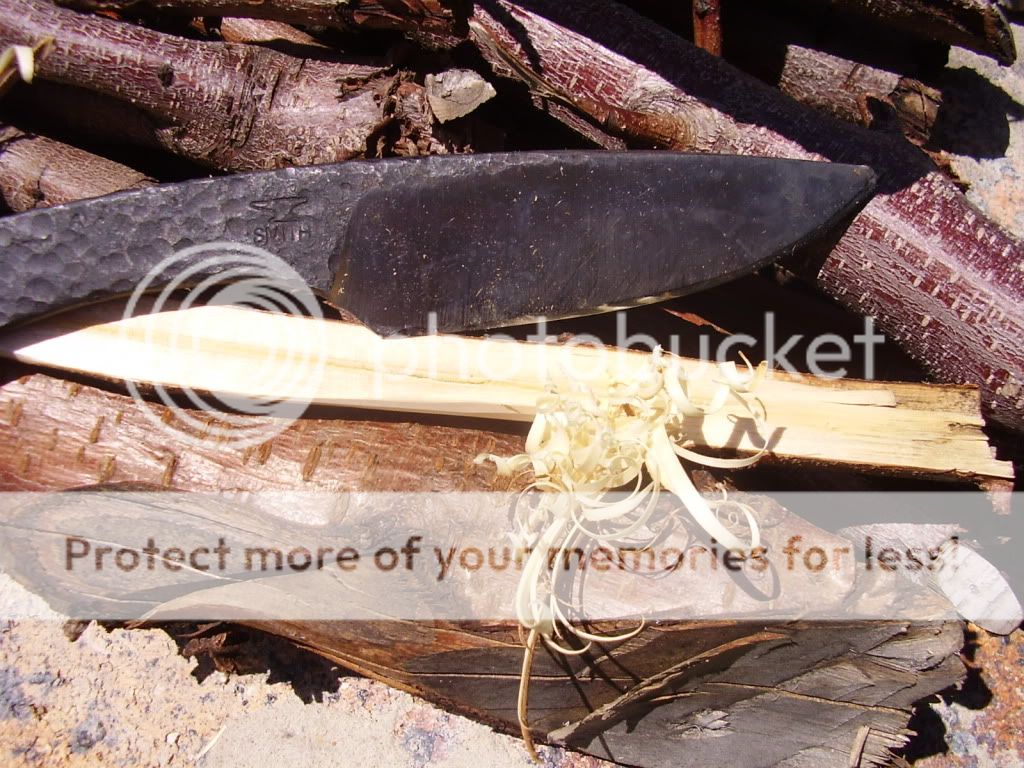

And some feather sticks
I also used the knife in the kitchen and this is where I got the biggest surprise. This thing cuts really well for its short thick blade (sorry, no pictures of that).

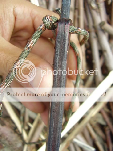

The only draw back was the handle. Due to its thinness it became uncomfortable in long periods of carving. This was resolved by wrapping some 550 paracord around the handle and I continued to carve for another 40 minutes without any hotspots. A great knife IMO, but is heavy for some and when you start to carry it. Once you get use to it you dont even notice it.
