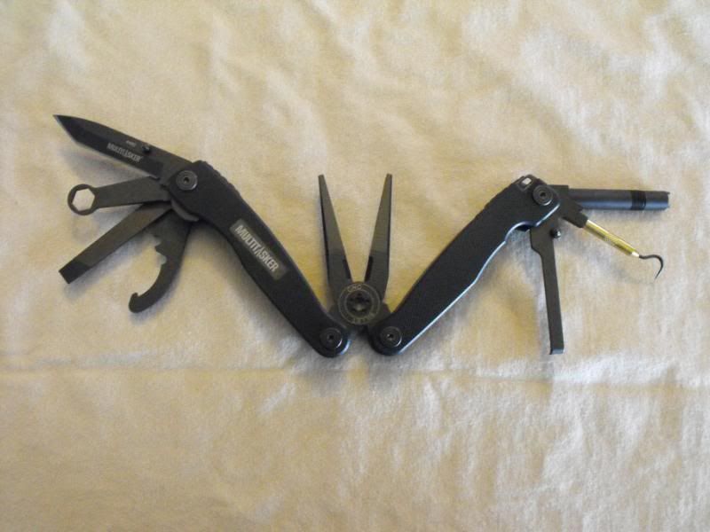

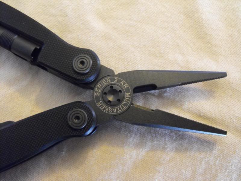

First up, the heart of any proper multi, the plier head. The heads on the Multitasker are, no joke, the best I’ve seen on any multi I’ve owned. CNC machined out of D2 tool steel, they are perfect in every facet. The knurling on the face is flawless and intermeshes with the opposing side perfectly. Coated with some newfangled process called Melonite, I’ve yet to scratch them.

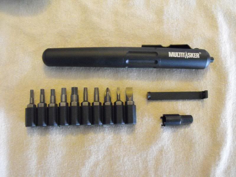

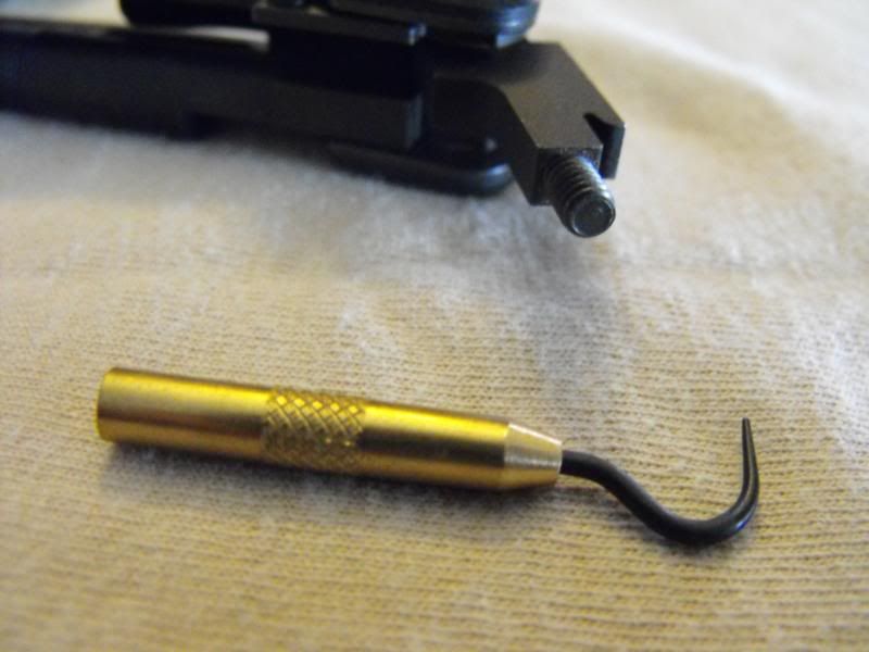

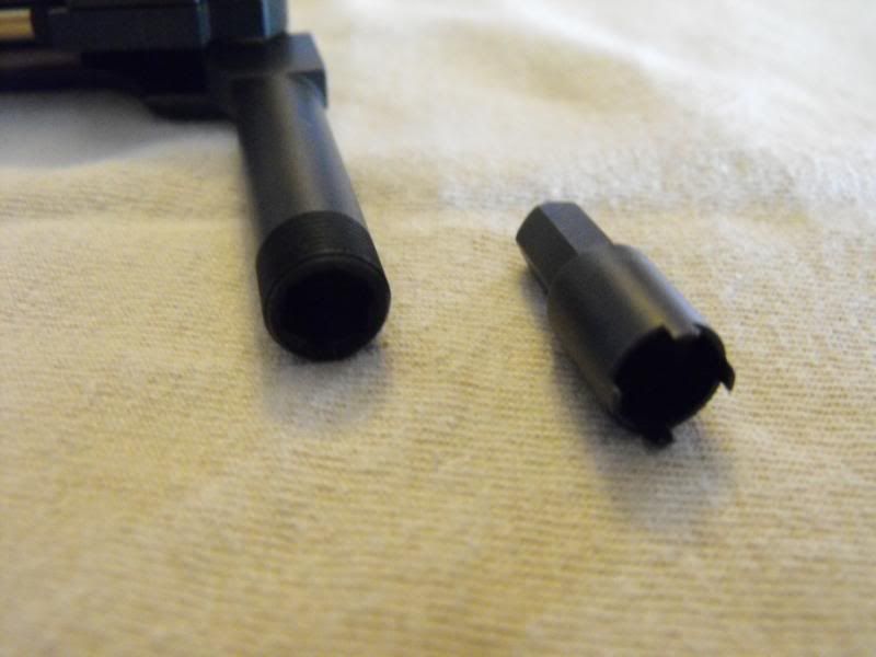

The array of tools is great for their intended purpose but you’ll find them lacking a bit for typical, EDC carry. They include: a castle nut wrench for M4-type collapsible carbine stocks, an adjustment tool for four-prong A2-type front sights, and a 3⁄8" box wrench for accessory mounts from LaRue Tactical and others. You also get an angled carbon scraper with radiused tip, file with 5⁄16" flat-blade screwdriver, 2½" Tanto-style 440C stainless steel blade with liner lock, wire cutter, a bit driver with 10 interchangeable ¼" drive bits, and a steel dental pick/scraper with 8-32 threaded male connector that can integrate with an Otis pull-cable cleaning kit (not included). Comes with 2 slot-head, 1 Phillips, and 5 hex-head bit tips, plus T10 and T15 Torx® head bits. Magnetic drive-socket ensures bits stay securely in place.

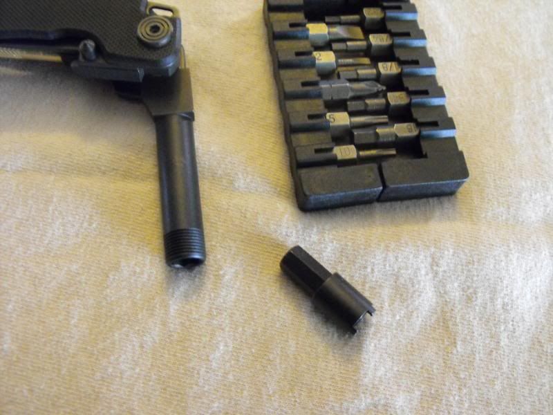

The sight adjustment tool fits into the screwdriver adapter and pulls out easily but is held secure with a magnet, nice feature. I really like the full sized bit capability. It takes up a lot of space of course but the folks at Multitasker made really good use of the real estate with the sight tool included.

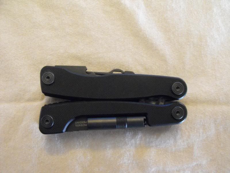

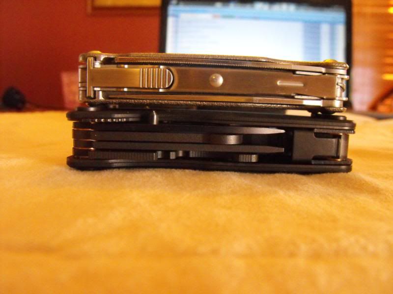

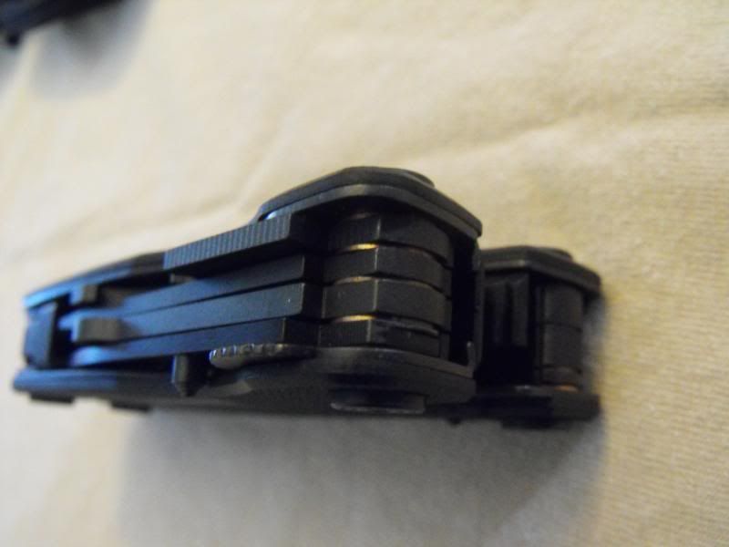

As I mentioned, this is a big tool. It’s on par with the Leatherman Surge as far as size is concerned but that size comes in handy when you need the leverage to break a bolt or castle nut free and trust me, this tool can take it.
Here compared to a Leatherman Charge.

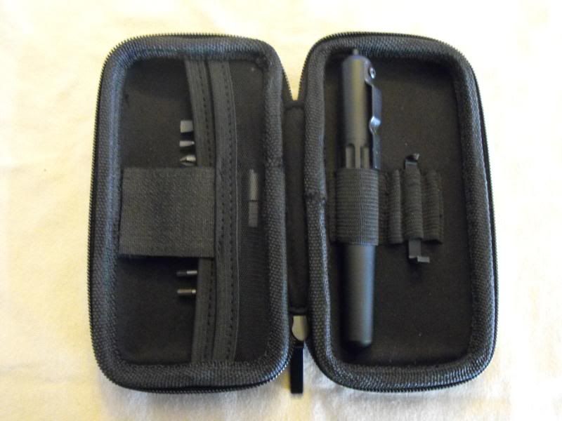

Next up….The TUBE…..
