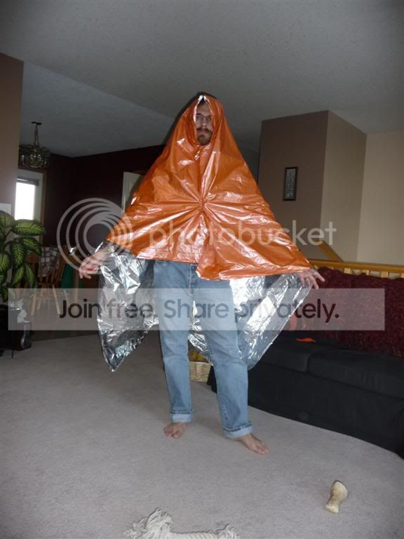

Okay, I just broke out the sheet and the clips, and they work great! You don't have to be terribly precise in your folding or anything; just gather some semi-neatly and clip it over, and they hold great. Even adding one to your kit would be helpful to hold it together, but two or three would be better. I know two would fit in the package... perhaps three.
Edited to add:
A-HAH! So, with two of these little cheapy clips, I can turn this thing into a poncho:
Yes, I know that you could do the same thing holding it with my hands, but this is hands-free. That leaves your hands available for carrying stuff, staying under your armpits for warmth, or whatever. I'm definitely going to steal a few of these from the kitchen. For what it's worth, I'm using the smallest length that comes as part of the multi-pack of them... around 2.5" long.
Great little test and with the added bonus, you could double for Stephen King at a distance! :D
