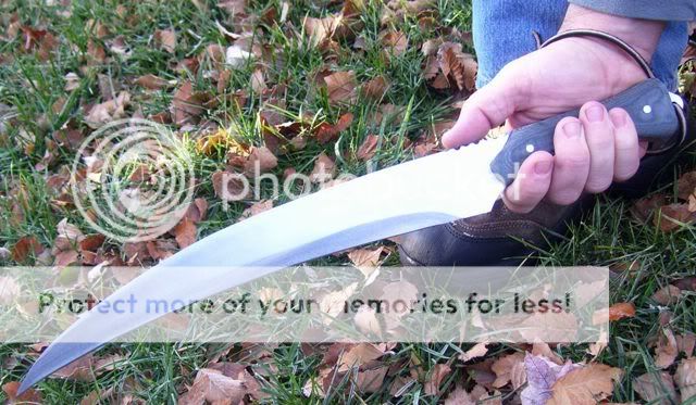

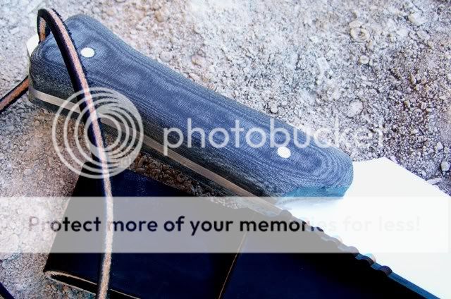

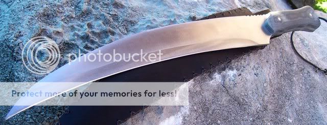

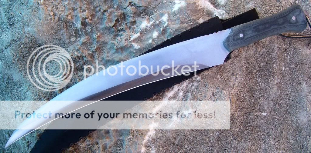

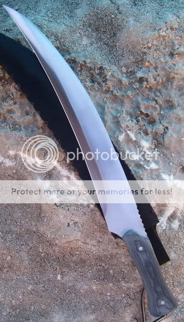

Hi all. This piece is inspired by our ancient design of the Thracian Rhomphaia Sword. Thought I’d make a tactical version. I’ll be adding it to the web site soon. Hope you like it.
Rhomphaia Tactical – For Sale
Shop Details:
5160 Spring Steel was cut out and Normalized @ 1500 degrees until non magnetic, three times, to remove stresses and align crystals. Heat Hardened until blade became nonmagnetic, then quenched in oil. Tempered the blade to a straw hardness @ 550 degrees for 1 hour, letting it air cool and repeating once more.
Measurements:
Total Length = 20 1/8”
Blade Length = 14 1/8”
Blade Width = 1 7/8”
Blade Thickness = 3/16 “
Handle Length = 6 ”
Handle Width = 1 1/8”
Handle: Black Linen Micarta. Scales attached with pins and glued.
Weight = 15 oz
